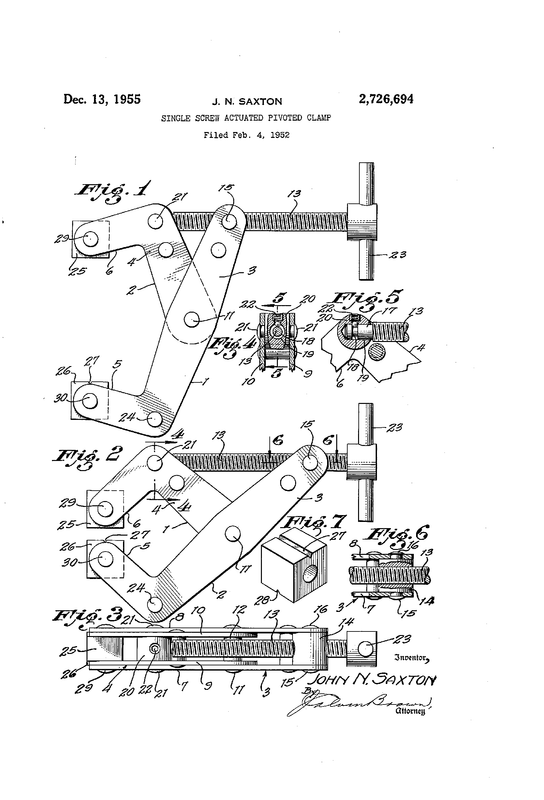

Vic05/12/2021 11:11:22
3453 forum posts
23 photos
I’ve seen one kit offered online but it was more expensive than buying them ready made. surprise And that was without import duty, VAT and shipping.
The patent ran out years ago and there are plenty of drawings around.

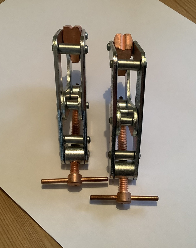

Vic07/12/2021 14:51:04
3453 forum posts
23 photos
Well, the replacement Kant Twist clamp arrived today and I now have not one but two twisted clamps!
Grindstone Cowboy07/12/2021 15:52:22
1160 forum posts
73 photos
Silly question, but they don't straighten up when in use, do they?
Rob
Vic07/12/2021 16:07:55
3453 forum posts
23 photos
As the threads are binding quite badly I’m not inclined to try. But I would say no, I don’t believe the construction is “loose” enough to correct the fault on tightening.

Vic07/12/2021 17:20:54
3453 forum posts
23 photos
I’ve had a phone call from MSC and all the rest they have in stock are the same. So it seems like a manufacturing defect. MSC are arranging to collect them and give me a refund.

Vic07/12/2021 19:09:58
3453 forum posts
23 photos
It’s time for plan B. Not sure when I’ll be able to implement it but I’ve ordered some 2.5mm thick steel sheet. I have plenty of round stock for the turned components. I’m going for a roughly 2” clamp and the KT had a 1/4” screw so I’ll probably use M6 studding rather than turn down some larger rod and thread it. Any clever suggestions for securing the head for the cross bar? I’m thinking just to screw on a larger “boss” and cross drill it say 4mm?
I’ll be using the plan pictured above. When printed out on my laser at 95% it is virtually the same as a 2” KT which is perfect for my needs.
