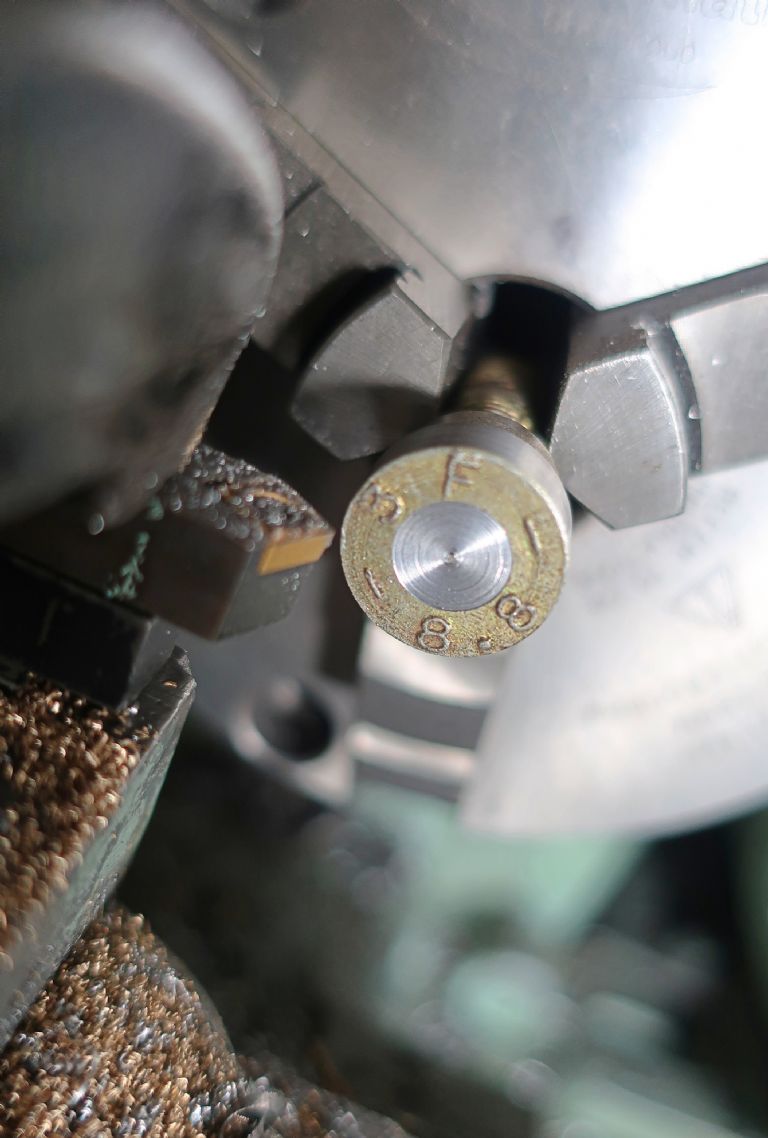

Posted by brian jones 11 on 06/10/2021 09:52:44:
I have formed the simple idea that using carbide
a) the tips are not sharp as per HSS, they are deliberately rounded slightly becasue a sharp edge in carbide would quickly chip and fail, so rounding gives better strenght
I can only assume that the tool tip with pressure reaches a high surface temp that softens the skin and lets mtl be rubbed off below - what an appalling thought
Maureen wasnt happy with even a mere 5 thou DOC
I did check the bolt and could use a file on it so not fully hardened
A puzzle?
Brian
A puzzle? Yeah, but no, but yeah.
Carbine is harder and more heat resistant than HSS, and it's at its best used far more brutally. The bluntness improves edge strength but also suits the rate at which carbide works best. It's counter-intuitive compared with HSS in that improving finish with carbide usually requires higher speed, feed-rate and greater depth-of-cut. HSS tends to improve finish by taking lighter slower cuts.
Problem with Miss Maureen Myford is she's too slow, weak, and bendy to get the best out of carbide, partly because her electric motor is called Weedy Walter.
Carbide produces good results on slower machines but it's a tad harder to get good finish with it: experiment.
The bolt not being fully hardened is a misunderstanding too. 8.8 bolts are tough rather than hard so they can be cut with a hacksaw or filed. However, there's no reason why a steel bolt should machine well. Ordinary mild-steel is a bit soft and smeary, Boron Steels are tough and smeary - an unfriendly material. Pot luck,

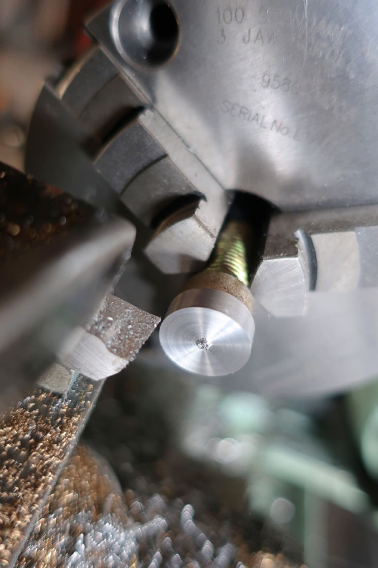

FWIW, from time to time, I turn 8.8 grade fasteners quite happily with HSS tools.
They need to be sharp and on centre height, with a fine feed.
Carbide tips are not as sharp as a properly ground HSS. In this way, they generate the heat at the point of contact to soften the material.
If you must use carbide tips, increasing the speed, so that you are running at about 3-400 fpm may help.
May be difficult to run fast enough if you are attacking a M8 bolt!

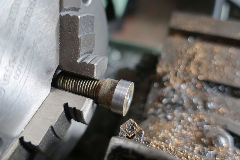

So which holder/insert were you using? yesterday you mentioned triangular inserts yet today you post a link to a set with no triangular inserts. Say which it is and I'll point you in the right direction.
The bolts are not hardened they are just made from steel that has a higher tensile strength that is not so easy to cut. If you want to use the bolt as a hob then it will need case hardening but then that's only surface deep and not so good for cutting tools better for wear resistance. better to get a bit of silversteel and make a hob from that that can then be through hardened

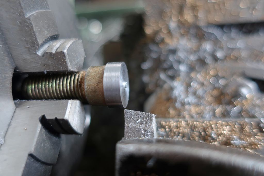

I turn HT bolts or srews on an ML7 every so often - using HSS or carbide tooling, I'll happily use either dependant on the requirements of the job, or even what happens to be in the toolpost at the timesmiley..
Hand fed, 5 thou roughing 2 1/2 finishing, top gear Carbide, middle for HSS, this lathe hasn't been used since the weather was hot, everything felt a bit 'dry' and loose..
The tip is used and what was in the tool, likewise the HSS, it did get a quick swipe with a slip.. The bolt looks like a seat-belt anchor..

Brian, did you even follow my link yesterday to APT? As well as decent inserts sold in two they have individual holders in a wide range of styles available individually.
I would stick with the CCMT and CCGT types rather than triangles and usually the holders are servicable so don't rush to get rid of them without at least trying with some half decent inserts.
I would suggest these for general use on mild steel and cast iron, yes that's almost £5 an insert with VAT and postage but they work unlike the 25p ones.
And these for non ferrous, stainless steel and more difficult steels
If you want a new 10mm sq holder then a RH one will do both turning along the length of the work and facing the ends so a LH is not really needed. You can also get individual 6, 8 and 10mm Sq from the likes of ARC, Chronos and JB Cutting Tools so no one is conspiring against you
And this is the finish with the fine feed and CCMT060208, don't have an Ra tester like andrew but it passes the reflection test at least in the middle (see Martins comment)
