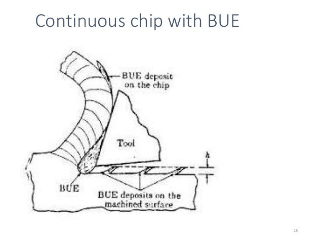

Steve mentions honing, which I've never done to an HSS cutter intended for use on metal. My logic, which could be wrong, is that metal cutters don't need to be super-sharp because they wedge rather than cut. Note in the picture below, the tool tip isn't in contact with the metal.
The wedging action is taken to the extreme with most carbide inserts which are on the blunt side. A sharp edge is only needed to start a cut or to remove tiny amounts of metal. As a very sharp edge is easily damaged and metal is hard, sharp edges are easily damaged.
It's still important that metal cutters have an edge, because being too blunt is a disaster. Never let cutting tools rub!
In my mind, metal cutting is rather different to slicing through soft fibrous materials like wood where being razor-sharp is a major advantage. I don't see any value in honing lathe tools. Am I right?

Dave, er, isn't that an illustration of undesirable cutting conditions caused by Build-Up Edge deposits?
