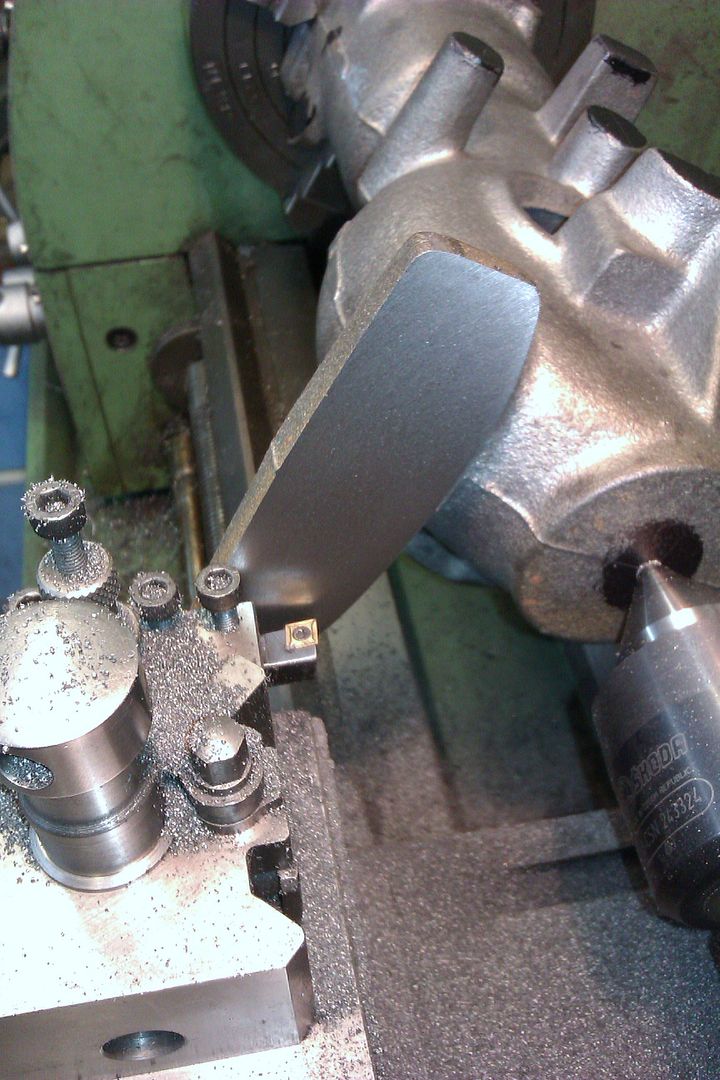

Same here, this one for example would be about 9" across the corners so a good interrupted cut, also a long way from the chuck and a lot of tailstock extension but an acceptable finish. Probably equal to about 400rpm on that small stuart casting.
Although, that is with carbide insert tooling, not HSS that the OP used. So you can use triple the cutting speed right there. And carbide stands up much better to the hard skin on cast iron where it will tear the edge off HSS if run too fast. And somewhat counterintuitively, smaller castings can have a harder skin because they chill off faster out of the mould.
I've used higher rpm on bigger jobs in the Myford with interrupted cuts too, but on plain mild steel not hard casting skins. Another trick is to use a block of wood against the chuck to help even out the shock loadings from the interrupted cut, most helpful on old lathes like the Drummond that have a bit of slack in the back gear drive pin/dog. (I haven't needed it since i got dragged kicking and screaming into the modern era with the ML7.)
