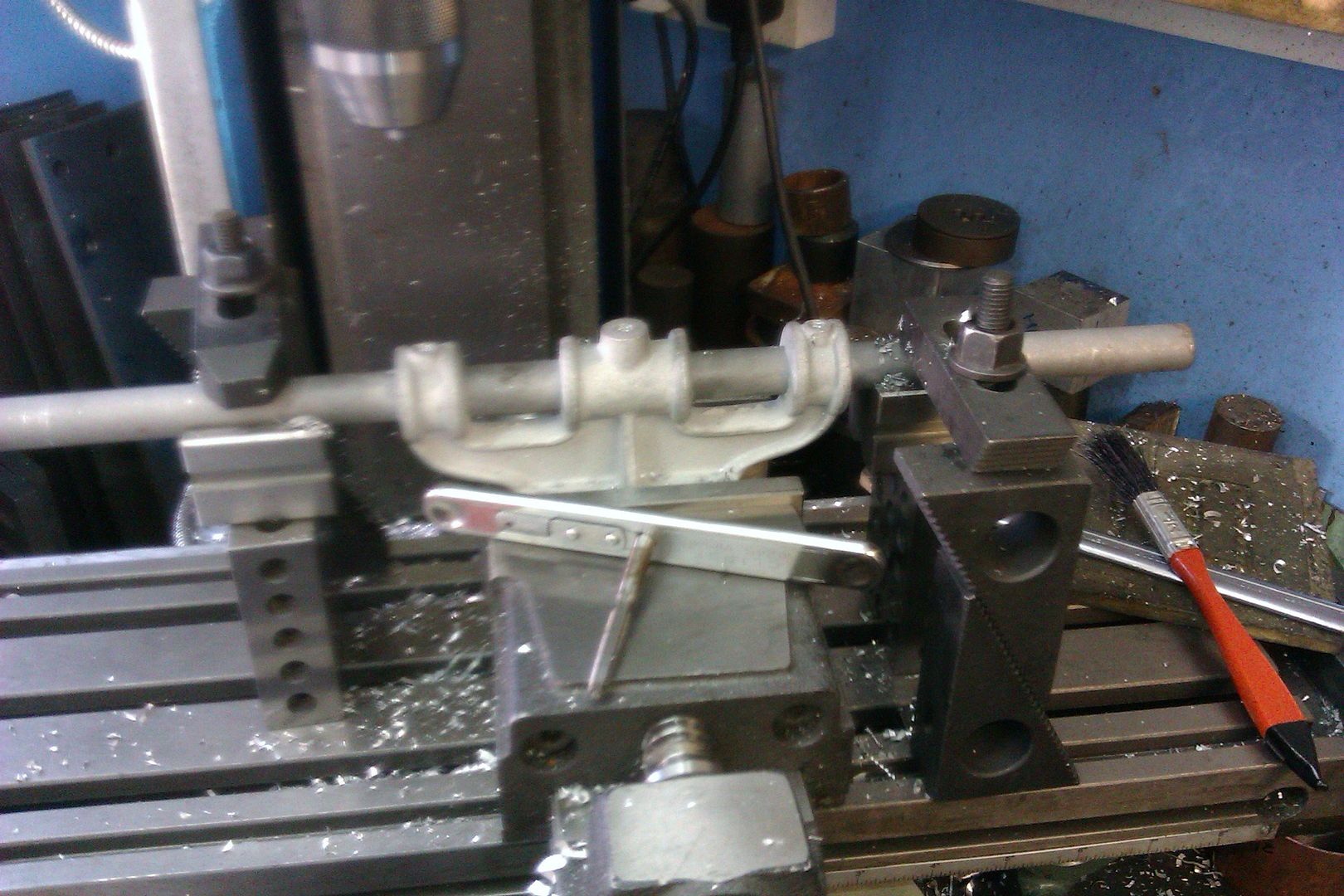

I did find the side groove useful for clamping a pair to the mill table when working an a part that needed to come out and go back into the blocks a number of times, being a deeper side groove than usual the hold down clamp fits well.. The type of clamp shown doe shave the advantage that you can still use it if block is laying on its long side or stood vertically in a vice.
To the OP the clamps are not there to apply a great deal of force, mostly just to stop a part moving when measuring or marking out so unlikely to suffer failure, if machining then a proper clamp should be used.
