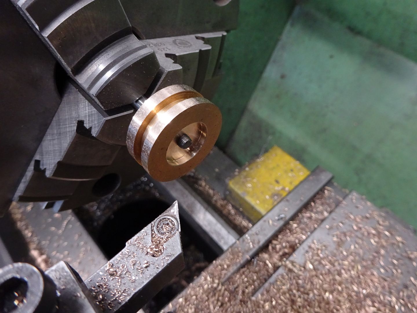

pity you did not give the sizes and through hole a day earlier as I would have taken a few more pics of this one for you. 0.531" dia x 0.080" deep with a M4 x 0.5 hole in the middle done with an insert boring bar. You have a couple of these to do soon.
