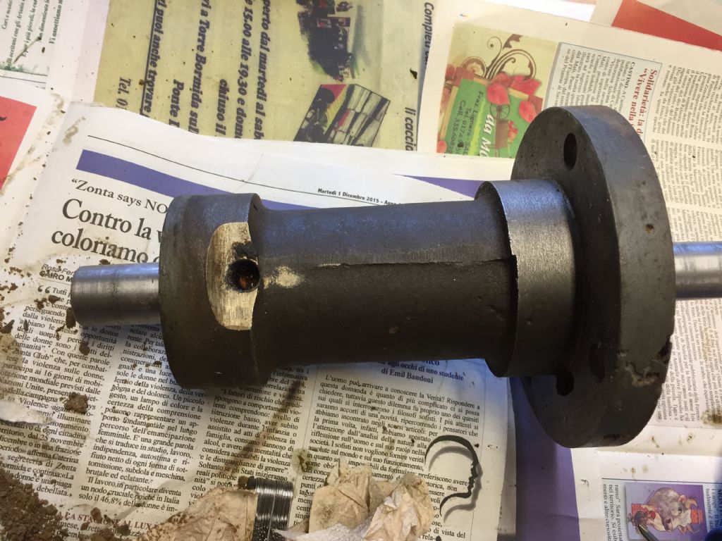

If both bearings have a step down on the shaft diameter in front of them then pressing either way should do. One end the shaft will press in, the other the bearing will press out on the shaft. If you have a vice that opens far enough to take the whole shaft I would try that first as you know how hard you are pushing the shaft. You get no feed back from a press till something breaks.
pgrbff10/03/2021 11:56:52
261 forum posts
31 photos
Both ends of the shaft are the same size as the bore of the bearing or taper down so I am hoping that it can be pressed either way. The bearings are identical, at least in diameter and bore.
There is a grease point only at one end of the hub, I'm assuming the shaft floats on the two bearings and grease passes from one end of the hub to the other alongside the shaft.
It just seems odd that there is no step or register to ensure the shaft is in the right position relative to the hub once you replace it. If not the pulley and the motor pulley will be out of alignment, as will the 2 cast iron saw blade pulleys.
So much easier to work with wood!

Forgive me if I am being stupid, but the first pic on this thread appears to clear show a shoulder close to that screwed on cover. I suggest you you check again.

The Shaft is probably stepped at both ends inside the hub so that shaft will not float. So if you cut a hole in a piece of wood big enough for the outer race to pass through you might be able to knock the shaft through from the other end with a copper, rawhide or lead hammer. Use a piece aluminium or wood dowel to knock it through the bearing.
Do not use a steel hammer or steel drift on the shaft under any circumstances.

Posted by not done it yet on 10/03/2021 12:18:50:
There is a shoulder. To the left of the shoulder, the shaft tapers down, to the right of the shoulder it is the same diameter as the bore of the bearing. I'm not sure what I am missing?

Posted by Dave Halford on 10/03/2021 12:24:58:
I have tried using a steel club hammer using a dense piece of hardwood as a drift, more or less the same diameter as the shaft. It won't budge. Do not have large copper or lead hammer, unfortunately.

If no joy by bedtime, put it in the freezer overnight then get out in the morning and give it another thwack, less destructive than heating and you may get lucky. When it comes to freeing things off one good hit is better than a lot of little taps so plan ahead and have a way to support it so you can thump confidently. I'm **guessing** that it will either be a plain shaft with a tubular spacer between bearings, or have a larger diameter internal section with shoulders and maybe some shims, and will come apart from either end.
That said, how much do you intend to use this saw once rebuilt? You now have good access to the bearings so could flush them out, relubricate and see how they run. May be good enough.

Less convinced about my freezer idea now. The shaft will need to move on at least one and maybe both the bearing inner races, cooling the whole lot won't do much there. Perhaps put it the freezer and then allow to warm up in the sun or on top of a radiator, some differential effect might occur to loosen it.

Option Two, a blind flange with 4 holes on same PCD as those shown.
Four lengths of 12mm studding , tight as you can pull them up , heat the body,, hot as you can , hit the flange with at least 2lb hammer , hard, tighten studs again, repeat, etc.

Are the holes on the small end really 12mm? If the bearing is 52mm they look less than that.

Posted by J Hancock on 10/03/2021 14:23:45:
The flange is cast iron, guess what hitting it hard with a 2lb hammer will do?

I believe the theory was to make a blank plate with 4 holes at the pitch diameter of the holes on the small end of the casting and then use the manufactured studs ( to what ever thread they are). Then use these to apply pressure to the manufactured plate which will push on the end of the shaft. Then rest the large end on a good support and hit the new plate which has been pulled up tight to the end of the shaft. It isn't quite the same as hitting the flange with a large hammer.
It is either that or as has been said just clean it up and refit it.

Hi pgrbff, I can't guarantee it, but I image the cross section sketch below is what your bearing assemble arrangement looks like.
It is quite likely that the position of the shaft is fixed by the plate at the flanged end and the plate will nip the bearing in the correct place and there may be a small amount of end float on the outer race of the other bearing. it is likely that the bearings will be a press fit onto the shaft.

Many thanks for taking the time to do the sketch. That is the conclusion I have come to, but I have little experience in these things. I have a friend with a press, he owns a motor workshop, and I'll have to try and get over to him. The trouble is lockdown prevents me to go to another province, Liguria, so I'll have to wait.

Have you got a 3 leg puller,you could use it to try to push the shaft out .This might work ,it might not but worth a try.

Using a three leg puller on the flange could break it.
Pressing with the flange supported almost to the bore would be safer.
Once the shaft is out, you can either remove the bearing from it, and then use it to press out the other bearing, or turn up a dolly to do the job. (If possible large enough to press on the outer race. ).

Finally apart. Exactly as Nick suggested. Had to find someone with a press in the end.
