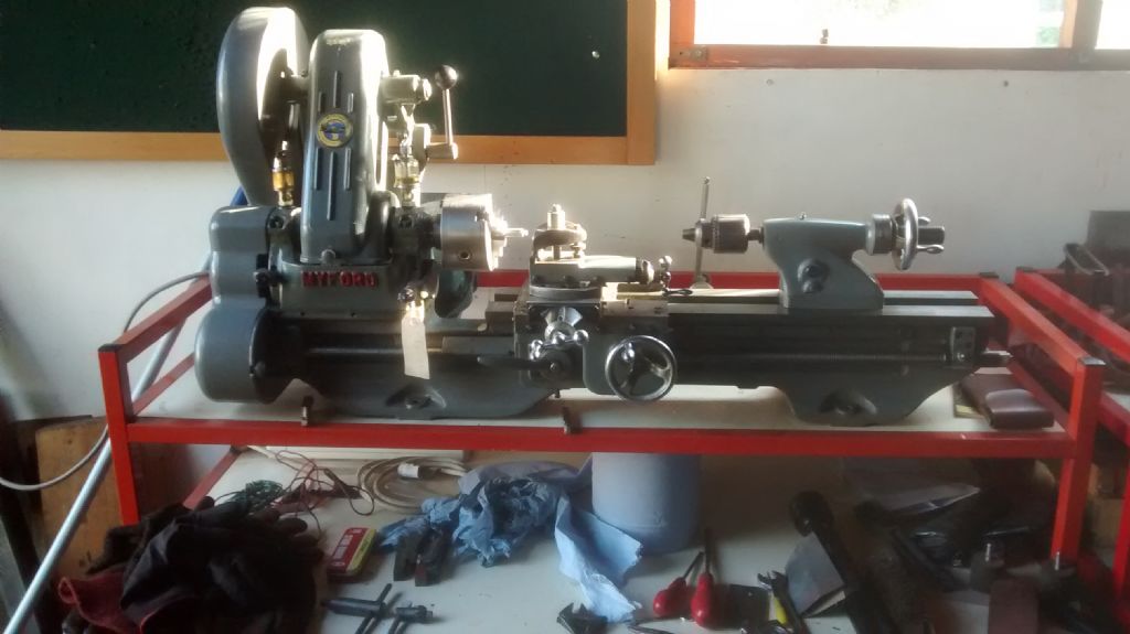

Maurice Taylor27/10/2020 18:01:17
275 forum posts
39 photos
img_20150513_182725659.jpgThis was what I put my ML7 on to get going ,worked ok until I made a proper stand.Its on wheels as well.
Maurice

Hi William, Your design sounds very similar to mine.(Photo earlier in the thread). It is made from 50 x 50 x3mm square tube, It does not have diagonals and is very strong.The extended feet make it very stable.It is based on an MEW articlle from a few years ago.The base plate under the lathe is only 18guage steel ,the lathe is bolted to the 2 cross members. I think your price quoted is good.
