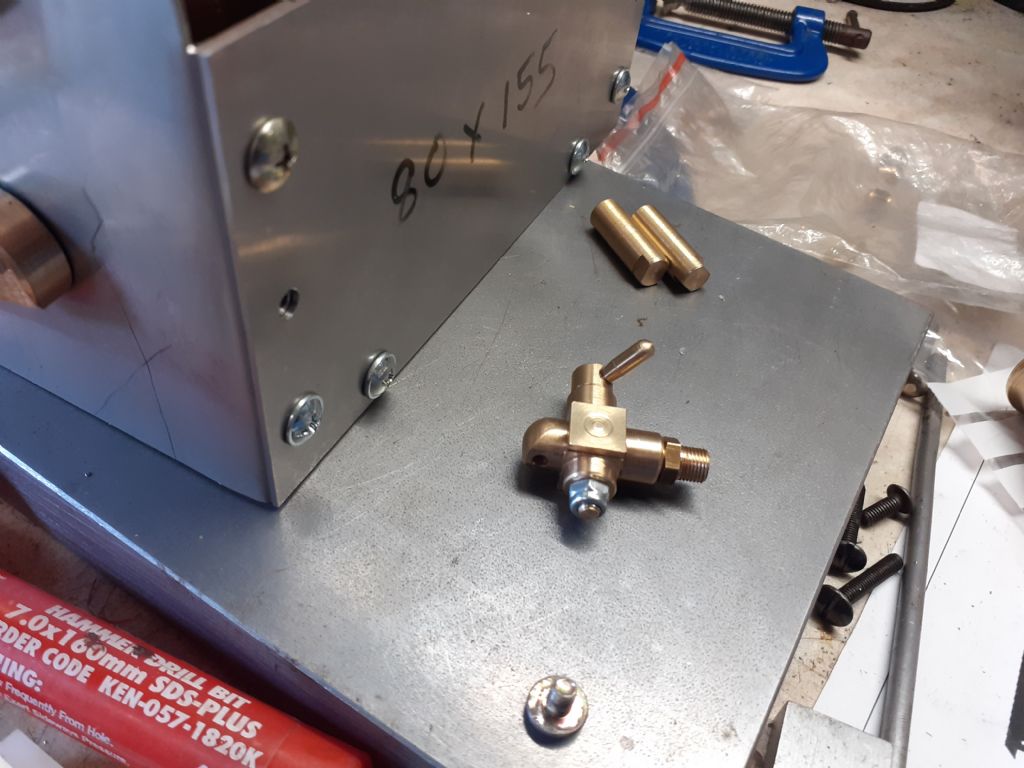

Made a bit of progress on boiler and made a small drain cock for condensate in chimney, made chimney and started mounting boiler and engin.
David

That looks really good David.

Yes, agree with Pete, looks great.
The smoke stack puzzled me but having looked at the drawings on steves website I can see that it is for the engine exhaust.
Have you made a burner
Geoff

Hi Geoff. I have ordered the burner from Forest classics and the safety valve as I thought it would save time but it hasn't come yet.
