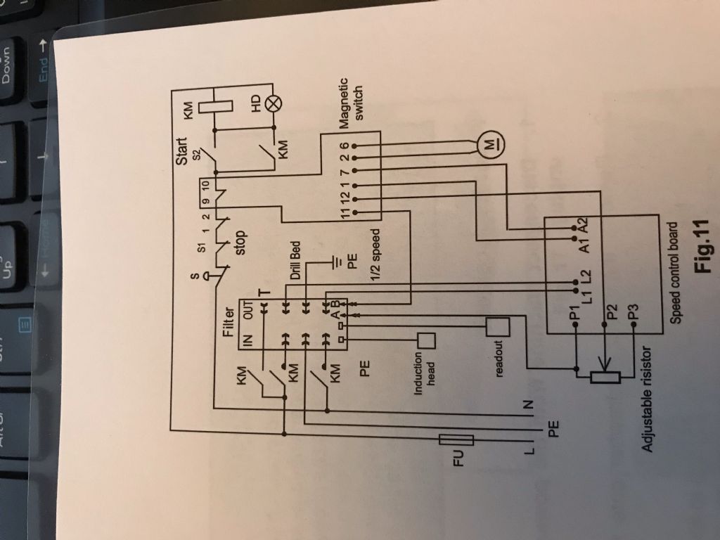

OK so I forgot about this problem as the weather warmed up. I cleaned all the tapers i use on the milling machine and the bore itself. The problem seems to have gone away for now.
Trouble is it does not end there.
I was running at top speed milling some bronze the other evening and the speed counter stopped working. Before i start dismantling the think has anyone else experience this problem?
Is the speed calculated via the drive or is it a counter of some sorts on the spindle?
Bri

Hello Bri,
I had the same problem on my Weiss.
Look under the cover at the top of the spindle. There is a plate which runs through a sensor.
This became contaminated with grease. Gave it a clean, and it worked as it should.

I removed the top cover but there is nothing hiding in there.
I also had a look in the control box, there is a ribbon cable that goes from the digital display to a small circuit board and that looks ok?
This is the circuit diagram that came with it.
No signs of a tacho?

ERM i put it all back together there really was nothing. Just the motor and the casting top!
I think its generated by the filter somehow?
Bri
Boiler Bri17/06/2019 21:23:07
avatar
856 forum posts
212 photos
Just spotted that there is an induction head, maybe that's something to look for by following the wires. Too bleary eyed now and enjoying a Dads day beer beer
Will try tomorrow
B

Hi Bri,
I would remain convinced, for the moment, that the tacho reading is more dynamic.
Can you post some photos of the general gubbins ?

Hello Daniel,
It looks like you were correct. The motor is mounted on a plate and underneath is the disk and counter unit.
Running at high speed has sent all the grease outwards and into the unit.
Thanks for your help.
Brian
