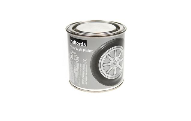

Another version of Neil's suggestion above.......
I have a target spotting 'scope and the rubber covering went tacky after a few months. I painted over the offending rubber with Al Frauds black tyre paint and it provided an instant cure. Maybe easier to control the application over small areas with a brush than Neil's spray paint?

OK, maybe an overcoat might help. The binoculars that are affected have been kept in the case in this country, and the radio is out in Spain and does get hot at times. Initially I thought heat and sun was the problem, but the bins are kept at UK temp and out of the sun. Interestingly my bins in Spain are not affected at all! Where can you buy this paint, I might give it a go. Did you clean off first or just paint over?

" Where can you buy this paint, (See below). Did you clean off first or just paint over? (Paint over) "
Halfords Tyre Wall Paint Black 250mlHalfords Tyre Wall Paint Black 250ml £4.99
