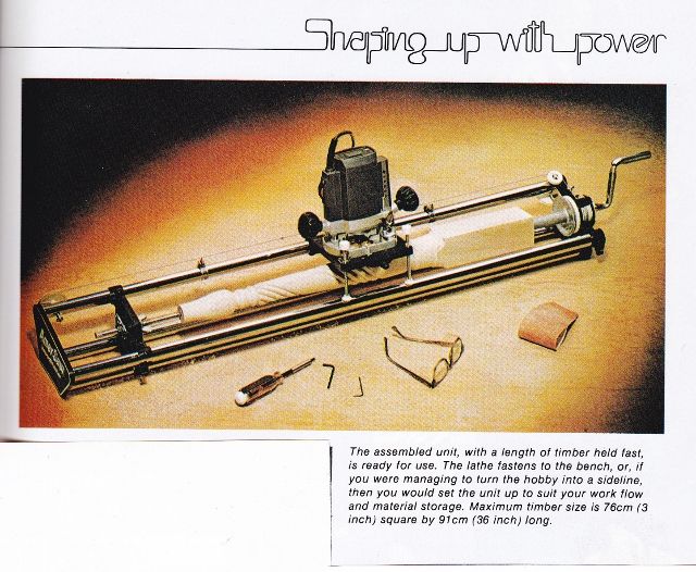

In my wood turning days (30yrs ago), I used to make candle sticks, sometimes with two twist, but usually three, these were just marked out ,then drilled free hand half way through to make a hollow stem. Now my nephew has one of these things, and it would probably do your job to. Nephew's grandfather got the lathe to make ornemental walking sticks.
Ian S C
Edited By Ian S C on 19/06/2018 15:32:57

Hopper20/06/2018 10:29:24
avatar
7881 forum posts
397 photos
Posted by Ian S C on 19/06/2018 15:29:58:
Ian S C
That looks like it would suit the OP's needs better than jury-rigging a model engineer's lathe. Does it have a brand name?
Michael Gilligan20/06/2018 11:29:38
avatar
23121 forum posts
1360 photos
Posted by Hopper on 20/06/2018 10:29:24:
Yes ... probably several, but the one most of us mentioned was the Trend RouterLathe.
[see p1 of this thread]

Yes - essentially you're all correct. I had a trend router lathe but it was lost in a house move before I could use it and I had to stop woodworking for a while so I didn't replace it.
More recently I've ended up in a wheelchair with mobility problems and a full sized set-up is beyond me to use so I decided to put together a miniature workshop and concentrate on small decorative things like boxes and clocks - hence my desire to make barley twists from maximum 2" x 8" stock but usually smaller.
The trend router lathe will be too large for me and also I think not accurate for the scale I want to work at.

To be honest, John ... I think the best bet would be to build a scaled-up copy of the Pen Wizard [probably with something other than the simple mandrel].
There is a lot of information on their website !!
... and nothing wrong in making one for your own use.
