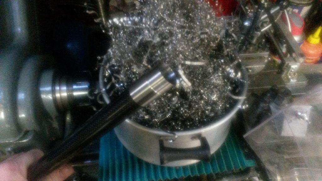

Titanium tube end adapter and the waste generated from machining two such adapters from solid, carbide tooling run dry on a Myford S7
No fires, no drama, no problem
