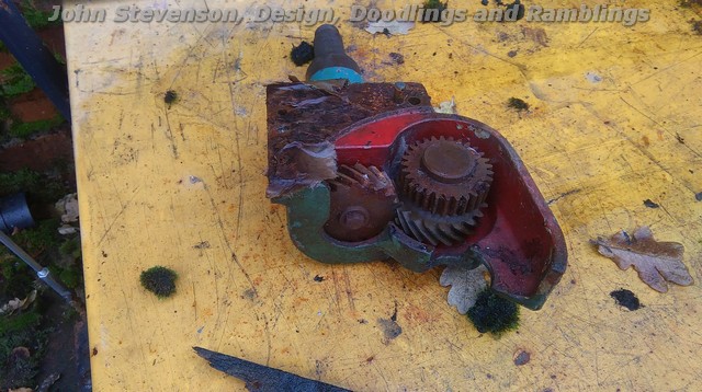

Sorry Mark,
These all came off bigger heads and are far bigger on the gears.
The gear in this pic is well over 2" in diameter.
If you want new gears then for just 3 off HPC is probably the best bet but you do realise you only need these gears for spiral milling or compound dividing.
Normal straight dividing just using the plates doesn't use these gears.
