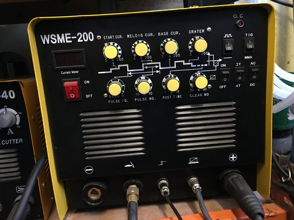

So I have been busy but bought myself one of these:
they have both good and bad reviews, but bought from a UK reseller incase of issues and delivered to the door.

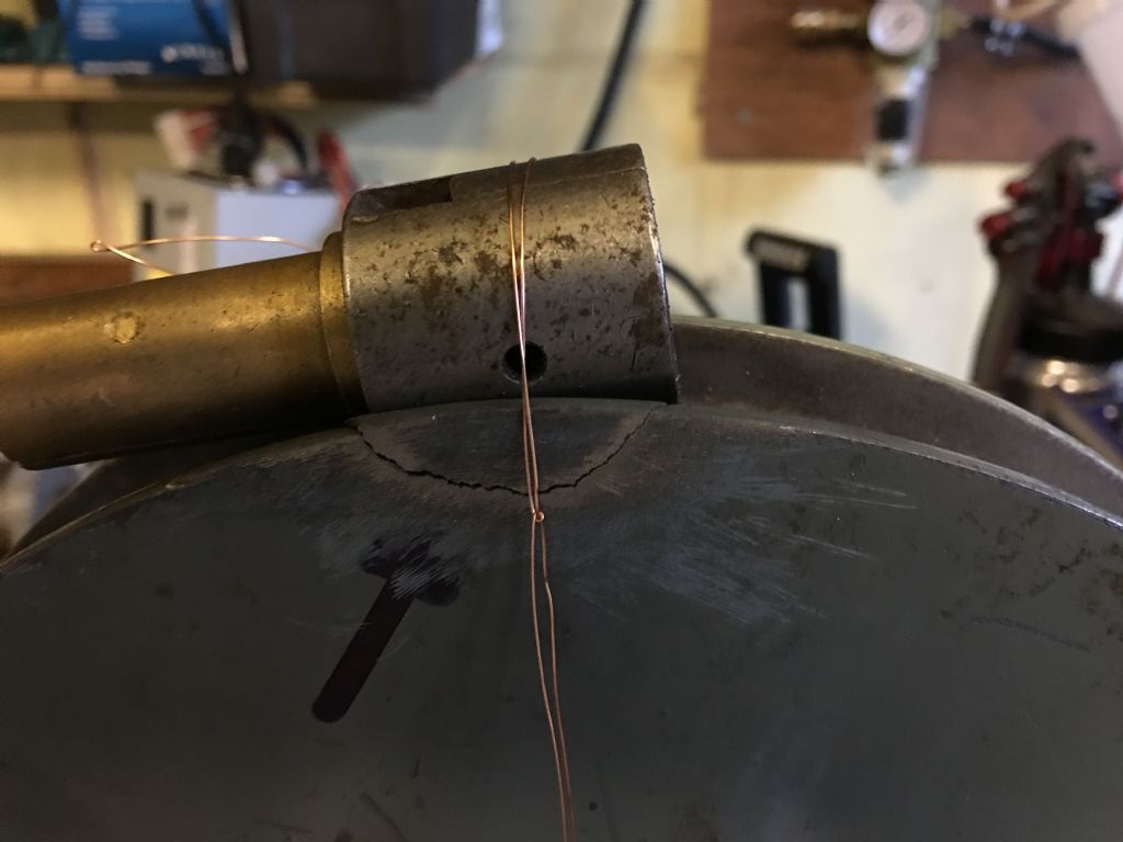

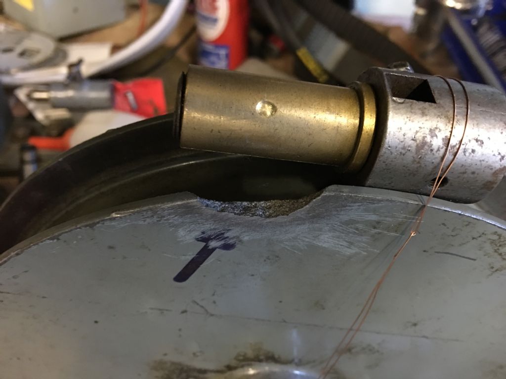

then set about welding the chip back in place. I have not used TIG before but used MIG for many years.
preparation of the surface and held in place with the bore head.

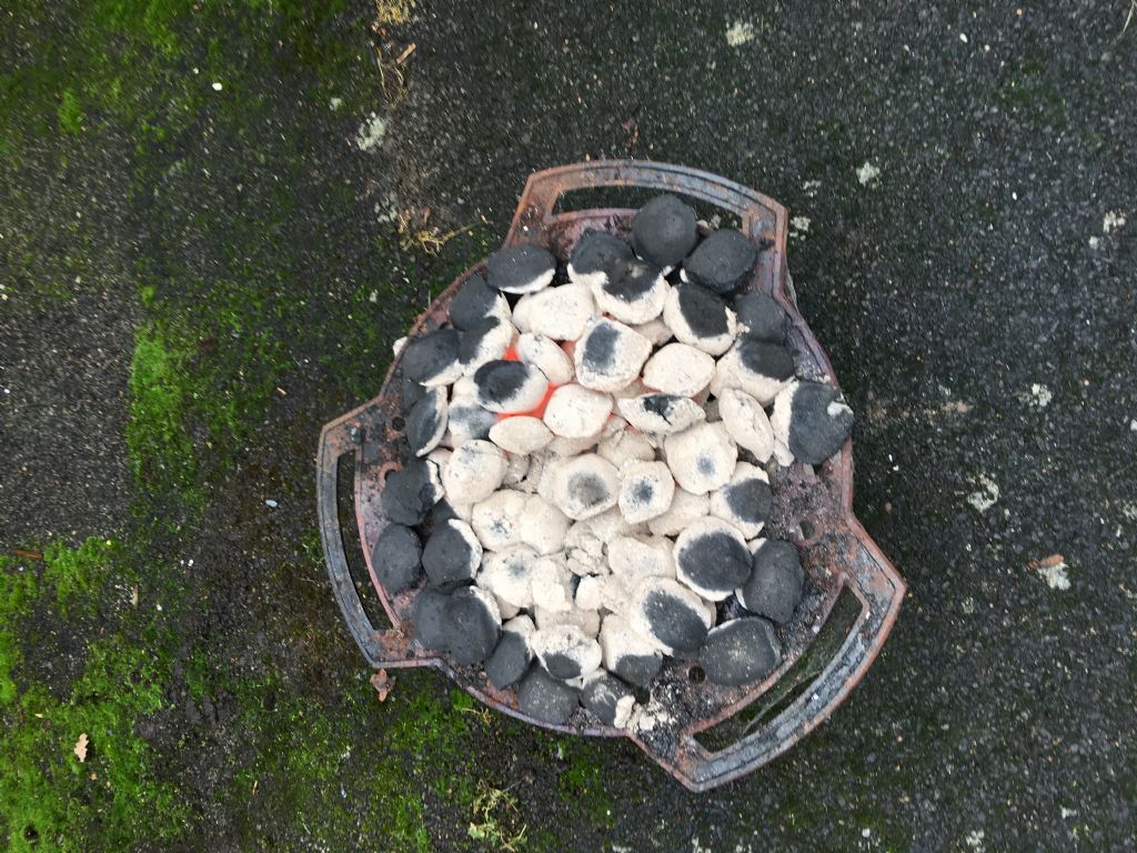

Having looked at a number of posts and using a bit of common sense... I looked to heating the part to remove the Possibility of thermal shock using a BBQ grate:

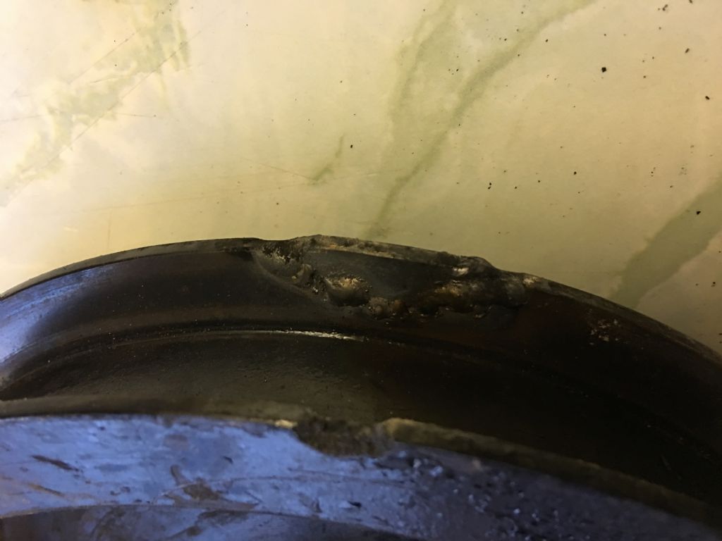

once toasty and warm I attempted the weld with nickel 55 welding wire:

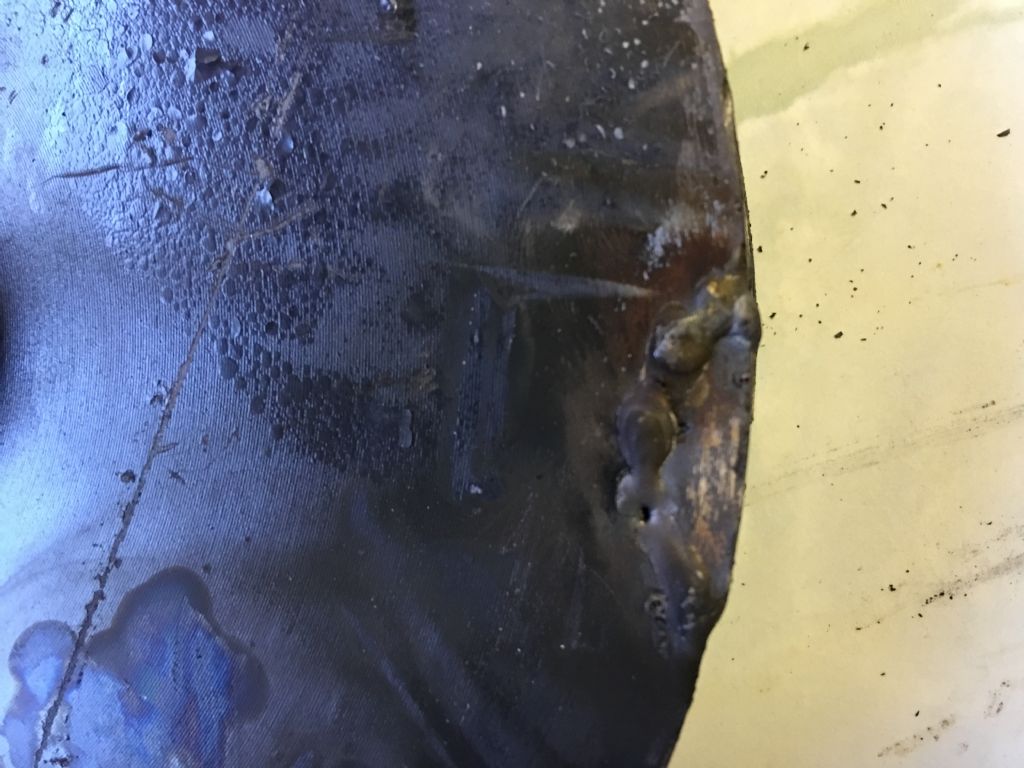

the out side was a bit of a shocker as the test welding I had done was on steel and the torch behaved as expected but on iron and with the nickel wire, the wire just evaporated and I pulled away from the wheel. that is why the weld looks a bit 'bitty'. The inner weld went a little better but still uneven:

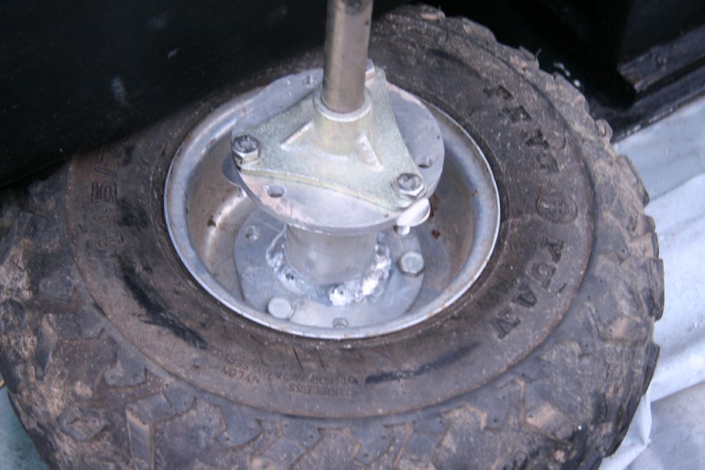

I can see that TIG is going to take me a while to get used to and all the knobs and switches are confusing let alone the multitude of types of Tungsten rod for differing material.
I even had a go at aluminium the other day for an axle extension to a go kart. Not the clearest picture but it was easier that I imagined it would be.

I used a 1.6mm Thoriated (Red) tungsten as the edge was 5-6mm thick and I didn’t want to melt holes.
The wire was bought off eBay. 1.2mm x 10m 18 SWG Nickel 55 Wire TIG Weld Cast Iron Repair and the forums kept touting that you could use it cold but my gut was telling me to pre heat and cool slowly.
The welding bit was more like soldering as the wire just evaporated. I am used to dabbing the rod into a crater but the rod never made it so I would pull back and the arc would be lost. Starting again only left porous holes.
I was using 45amps and this could have been too high but any lower and I get the feeling that the iron would not have melted as you can see the weld line is fine and not over exaggerated.

You do not need various flavors of Tungstens, just a few sizes. I use 3/32" almost always, have 1/16" and 1/8" in reserve. I use 1.5 Lathinated because that what was the best at the time. Use what You have and don't over think things. If You get specialized often enough You can adjust accordingly.
