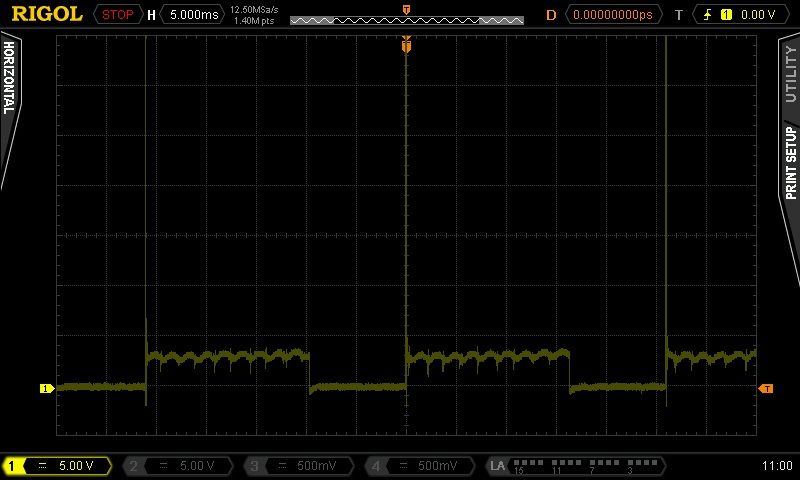

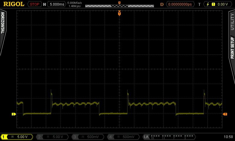

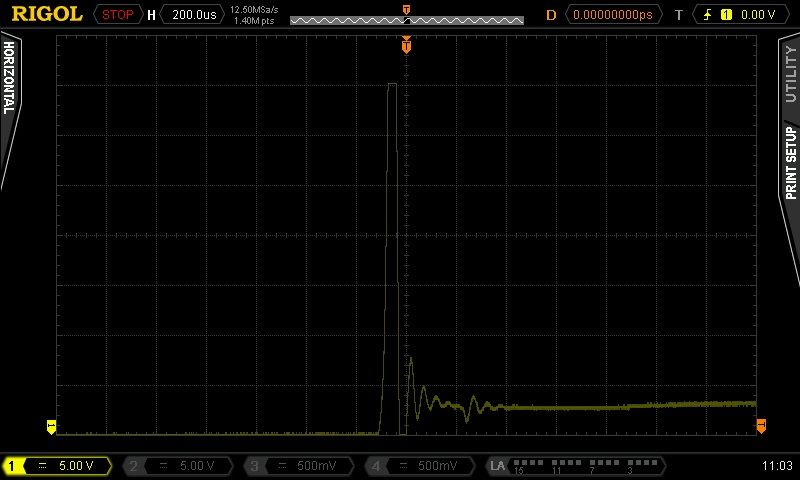

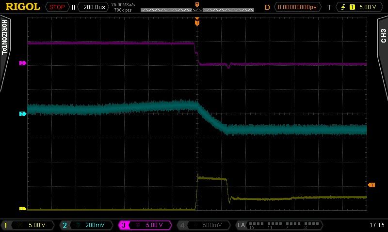

Thanks Jason. First try so lets hope I don't mess it upwink

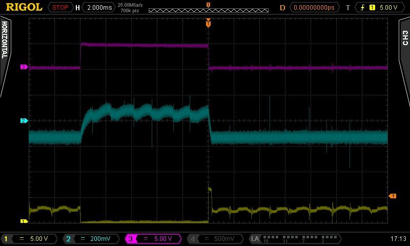

Effect of the Schottky Diode across the motor.
These DSO pictures show the effect of placing a Schottky diode across a 545 motor, taking ~1A, on a 7V supply.
The measurement is made across the power MOSFET being used as a switch. So the baseline is just above OV and occurs when the MOSFET is ON. When it switches OFF there is an inductive kick which is what we need to focus on. After the kick the voltage drop back to the motor generated EMF and the commutation spikes can be clearly seen.
Picture 1 - the schottky diode is fitted and the spike is limited to just over 7V
1 overview of waveform with diode fitted
Picture 2 - As above but picture is expanded to show the clipping of the pulse with the diode more clearly
2 switching edge with diode
Picture 3 - schottky diode removed - the pulse is now 35V high
Picture 4 - expanded version of Picture 3. The clipping of the waveform at 35V can be seen as the body diode in the MOSFET begins to conduct.
4 switching edge without diode
This makes the case for the schottky diode even at low powers on a small motor. The energy going through the MOSFET during avalanche breakdown at 35V will cause the MOSFET to heat up by a surprising amount. Much better to let a diode push it back into the motor where it will do useful work.

Michael Gilligan22/05/2015 14:56:27
avatar
23121 forum posts
1360 photos
Very informative traces
Thanks for posting them, Trevor

I've found all this discussion very interesting, and as a result I've added a transistor driver stage to the FET I'm trying to control from an Arduino. The end result is to control one of those ex radar blower fans to drive a street organ. 24V at about 1.5A
I see the argument for not having a flywheel diode, but I don't want to blow the FET. Is it worth trying an RC snubber as used on AC loads? Start with a low R and increase it until the spikes get to say half the Vdss.

Hi Duncan,
The only argument that seems to make sense to me for NOT having a flywheel diode is to save a few pence. I suspect the motor you are using is series wound so it's characteristics will be very different to a permanent magnet motor. You do not say if you application is just switching the motor on and off or for PWM speed control.

Les is right you may save a few pence on the diode but you are getting no other benefit from not fitting the diode. The faster the PWM the greater the energy saving by fitting a diode ( and the cooler your FET will run).
Its worth checking if you can separate the armature from the field winding. If it was serial connected it would have poor speed stability so I would expect parallel wound. If that is the case constantly power the field winding and connect the armature to the controller for best results.

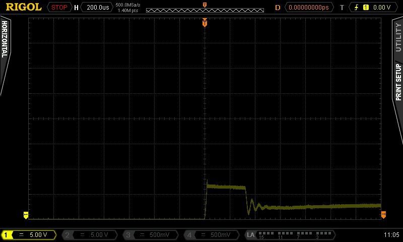

On the subject of the diode I have produced another trace (shown at two different timebase speeds so you can see both the big picture and the detail)
Sorry the current trace is a bit noisy but it is a homemade probe (unfinished project) however it shows the effect of the diode quite nicely.
The motor in this test is running at part speed on a 7V supply at 1A
Key:
Purple=drive into FET Gate which shows clearly the point at which the FET is turned off
Yellow=FET Drain voltage
Blue=current into motor(=FET+Diode current)
6  motor current with diode
5 motor current with diode
The important thing to notice is that current continues to flow INTO the motor after the FET has been switched off i.e. the motr is getting MORE power it is NOT being braked.

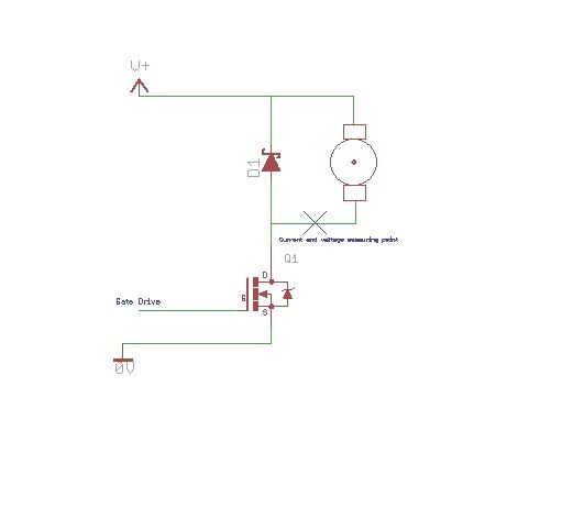

For clarity I have included the relevant part of the circuit showing the mointoring points.

Turning off a tap against a lot of water flowing produces "water hammer", which is caused by a rapid increase in the pressure across the tap as it tries to suddenly bring the column of water behind it to rest. You can't suddenly stop a large mass that's moving at a decent rate. The current flowing in an inductor (such as a motor winding) behaves in a similar way, so if you try to turn it off suddenly, there will be a rapid rise in voltage (pressure). Trouble is, if you try to turn a power semiconductor switch off slowly to reduce or control the voltage transient, you will make it very hot, so the skill is to switch it as quickly as you reasonably can. You have to manage this kind of switching event very carefully and it forms the very basis of just about any switch mode power electronics circuit.
The PWM circuit in the article is rather like a water pipe (current in motor) with a fast tap (the FET) - but with no relief for the water hammer (the snubber is too small to do anything). It's subjecting the switch to the resulting voltage transient. "Avalanche breakdown" is where the switch breaks down and conducts, rather like a pressure relief valve. However, as the switch is passing both current and voltage simultaneously, it sees a high transient power dissipation which isn't good for it unless in moderation. Modern MOSFETs are inherently able (and optimised) to withstand some limited repetitive avalanche energy which is usually specified in the datasheet, whereas bipolar switching transistors which were the only commercially viable option 20 years ago don't like it. When they start to break down through overvoltage, there is a runaway effect called secondary breakdown that results in device failure.
I've been working full time in power electronics since the early 80s and I learnt very early on how the basic topologies work and why you need a flywheel diode in a buck converter. The last thing I want to see is enthusiasts trying out electronics for the first time and ending up with circuit failures. I think we owe it to them to give good advice and circuit examples that are simple but robust and well designed.
