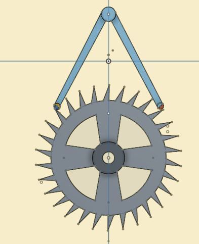

I have been trying to draw a Brocot escapement from the information posted here and on a couple of other sites. Does the attached look about right?
The escape wheel is 50mm diameter. The pallet arms are 37mm in length. The pallet OD is 2.2mm.

Bazyle16/05/2016 23:12:59

I hope that this is a bit clearer. Annoyingly, I cannot remove the small circles at the end of the teeth: it seems to be the way the software shows the join of the two lines that form the tooth. The dark blue and the brown semi-circles are th eoperating faces of the pallets.

No the right hand one should have just finished impulsing. The photo I posted always shows them as they should be with the left locking. That effectively means that the "pendulum" isn't vertical. It's at the impulse angle.
I haven't tried drawing it yet. Busy cleaning out a garage and outhouse but it will probably be best to show the drop / clearance on the left hand locking side. That will then put the edge of the right hand pallet at the flat directly on top of the point of the tooth = impulse just finished.

You have drawn the pallet diameter far too small. The diameter should be the escape wheel pitch (distance between tooth tips) less the desired drop. Typically the drop would be about 5% of the pitch.
For the escape wheel profile you have drawn the pivot point for the pallet frame is too far away.  It should be at a point where the tangents to the pitch circle at the locking points meet so that the pallets swing in the direction of the leading edge of the escape wheel teeth.

The easiest way to draw it is to put the pallets in the correct position and then construct the arms. You just need the actual position of the tips of the teeth to do that. In other word the very top of the active flank which is just a point. The arms come out slightly tilted at the impulse angle as the arms have equal length and the pallet centres are on a rad struck from the arms pivot. Then draw a tangent to the to get the active flank of the teeth. That way the arms can be any length. How the tangent is actually drawn has to account for no single angle being ideal for left and right impulses / locking. They are drawn tangential to a circle with a diameter of 1/2 pitch on the pallet centres. For an odd tooth count spanned on the locking side as drawn the tangent is clockwise from the pallet centre. For even tooth count anticlock. Drawn from the wheel centre touching the 1/2 pitch diameter circles.
The photo I posted shows how it's constructed, the middle 2 diagrams on the left. Drop / clearance is neglected at that point and the tooth pitch is used instead of the pallet diameter. Well that is the instructions. The ticks in the diagram are at 1/2 the tooth pitch
This is all done by hand at a scale of 10:1 or by CAD but to me the following calculations could be used to get at the actual dimensions from a simple sketch but it suggests doing this after drawing it out.
The instructions are rather weak on setting actual pallet diameter and position. That is what the lower left diagram is for - to actually calculate them. The clue there is that angle Y wont be twice angle Z as Z includes the impulse angle from the pallet. There is a need to think about what has happened as they are usually drawn. The pallet on the right has just allowed the pendulum to be impulsed and the wheel has turned clockwise. As soon as this impulse pallet clears the wheel will "jump" clockwise to take up the clearance on the other pallet. That will add to the impulse angle. To be honest I suspect books and other sources on designing things like this are sometimes just repeating what they have been told or have read somewhere and the same thing gets repeated over and over again with various modifications which may or may not be a good idea. What seems to be going on in this case is that the graphical method is aimed at getting dimensions on paper at 10x size that can then be transferred to scribers and a centre punch etc on metal. There is a suggestion that if higher precision is needed use the calculations. Done that way the drawing is just needed to get a grip on the maths needed. In this case the drop needs to be enough to account for the precision that the parts can be made to - not some arbitrary fraction of the tooth pitch that will account for the accuracy of a purely graphical method. Pallet diameter and position can be achieved to a few thou. The other error will be the accuracy of the divisions when the wheel is cut. So draw it out as it should be some how and do some sums. As shown the right hand pallet will be where it usually is but the left hand one will be a little clear of the flank of the tooth which just means that the that arm will be at a slightly different angle. The pivots of the 2 parts will always be on a straight line. Angling that may help when using cad. It's probably easier than trying to rotate the wheel.

O.K. In the common case that the working faces of the escape wheel are truly radial (unlike James' drawing) the tangents to the circle at the locking point meet at the pivot point of the pallet frame. Thus, for small movements of the pallets they slide along the tooth face with no movement of the tooth (dead beat). They are perpendicular to the working face of the tooth.
Sometimes it is convenient to move the pivot point closer to the wheel and the tooth can be undercut to maintain that perpendicular. In that case the lines drawn are, of course, no longer tangents.
John, Whatever the angle of the tooth it will be parallel to a diameter of the wheel. Was there a particular diameter line you were thinking of?
