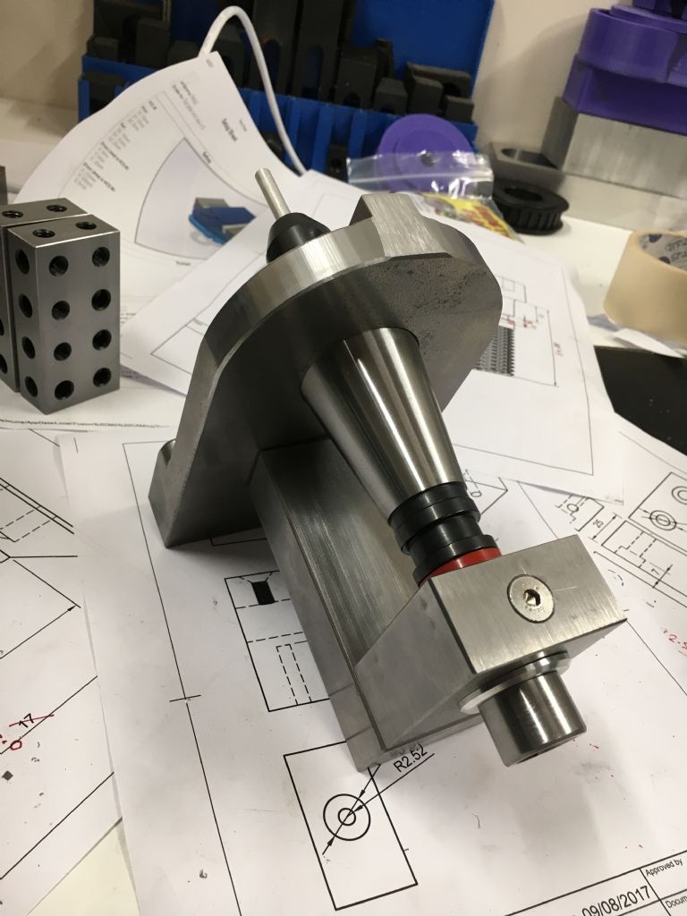

Finally made some progress out in the workshop. Lost a lot of time recently due to 3 weeks in China (work), 2 weeks in Wales / Yorks (hols) and bringing the ceiling down (planned and almost controlled!) in the new kitchen / dining room, so there hasn't been much activity out there for a while. I also spent some time commissioning the stick, MIG and TIG welders, so I'm back in the welding game again.
Previously I'd designed a tool setting fixture to hold my ISO40 ER40 collet chucks during tightening. There is no easy way to hold an ISO40 toolholder without damaging it, unless you have a suitable fixture. Tightening them in the spindle is not recommended and you could make a grand mess of your knuckles if you slipped when tightening a sharp new cutter.
This was largely a CAD/CAM/CNC exercise, designed to progress a complete design from the PC into metal, using my (now largely finished) CNC milling machine. It's a 1983 Shizuoka that I have retrofitted with a 3-axis Chinese Fanuc clone controller. Although I've now got a fair bit of experience with 3D CAD, this was my first start-to-finish project using CNC. All in all it seems to have gone rather well - no obvious dimensional cockups, no broken tools and it bolted together nicely.
The remaining component parts:Extension, foot, bolt and washer
Machine tapping with 100% thread in the manual mill:
Machine tappingFinished assembly. All parts fit like the proverbial:
Complete assembly
In use:
Tool setter in use
So that's another one ticked off! Quite a few milestones passed on the way, so feeling quite fulfilled. Time for a couple of beers perhaps.

Never mind a couple of beers, I think that effort deserves the whole case. beer ^ 10
Very impressive, and no broken tools, way better than I managed. It must have been a sizeable task on it's own justgetting the mill going.

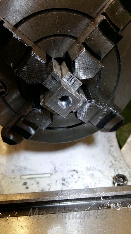

Yeh, realised same ... after I did mine...face 19​, will just have to make plug... anyhow did the counterbore for the stuffing box...
​Will have to rethink the gland follower stud spacing as didn't have 7mm counterbore so used 5/16" end mill for flat bottom... 0.9mm larger...so it put the hole centre distancing out... could have used 7mm drill I s'pose... thinking
​George.

Here I come with advice a bit late again. I am still using carbon impregnated string as a seal medium so I use ordinary twist drills for stuffing boxes and leave the conical seat at the bottom of the hole after tapping and then the flat on the end of the gland follower tends to compress the string on to the shaft. Counterbores or such are not then necessary. Small O rings are the modern method I understand, so a flat bottomed hole will work just fine or just leave the drilled seat.
