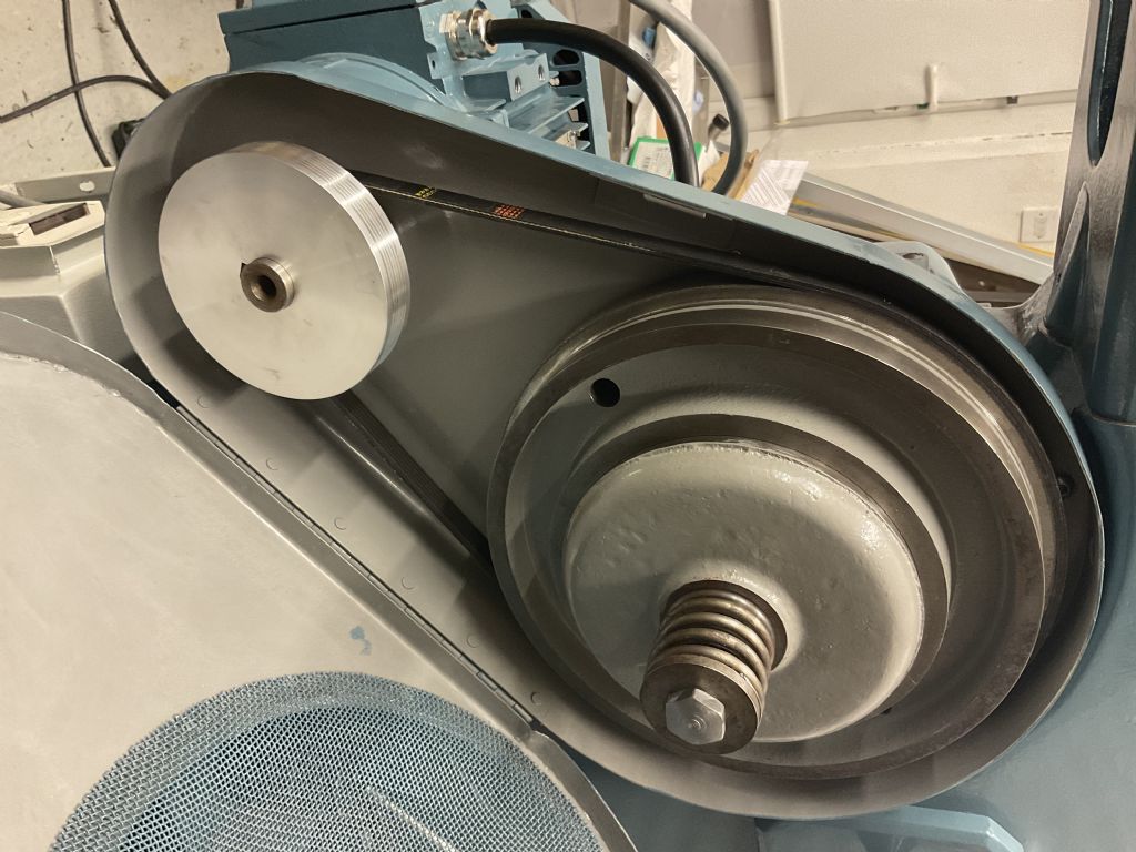

I’m not shaping yet but here’s a pic of my Alba 1A to Elliot 10M poly vee conversion. sorry it’s inverted.
