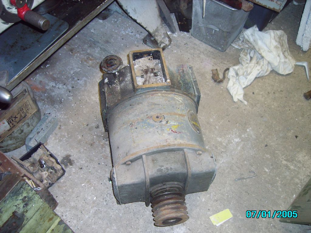

I did suggest to Chris in an earlier email exchange that the motor is given a day in front of a fan heater to gently warm it through and dry the windings out. It used to take out fuses in the house supply according to the previous owner, but that really isn't much of a guide.
The insulation checking by megger test has already been well aired and taken on board.
John. Phil said earlier on this was a commutator motor, as is his version of the lathe, and Chris's pictures show a standard 3 pin plug [Yuk] on the end of a heavy cable so it will be single phase. The speed rating is 750 rpm so it might also be multi-pole. I can't say I spotted a contactor but the grotty plug suggests it wasn't in use.

Right Chris,
Had a look at the motor, and I am not sure if it is the same as the one on mine, but I will be back at the shop later today, so I will look. My motor has a direct on line Allan West starter. Yours seems to have the AEI stayrite starter box with it, if this is the starter for that motor make sure you get it with the lathe! On the motor, you can probably get the grilles of and blow through with compressed air (wear a mask!) There is nothing you need to do to bring the motor up to modern standards (which TBH are not as high as they used to be anyway, but thats another thread!) Given a bit of volts drop on the probably too small supply cable to the shed, I am not entirely surprised it blew the house fuses, but it wants checking out before running.
Martin, if you look at the lathes uk pics then flip it round, that bolt does seem to me to be in the right place, and you can perhaps see the end of one of the pegs just to the left of the shadow of the gearchange knob, but you will find out tuesday anyway. Constant loss oil system in the sc gearbox, so there wont be much in it but muck 'n swarf. Looking at the lathes UK pic it does look like the leadscrew will come out when the taper pin is driven out, and it looks like the feedshaft is keyed into the gearbox as on mine there is a keyway visible in the boss that the feedshaft goes into. I think the "sliding gear outboard of the feed box" remark refers to the two gears which can be seen on the back view which are in the seperate case where the feed and leadscrew emerge from the box.

English Electric 3 HP Single Phase Induction Motor
I feel that I now know enough to test run the motor, too - I have carefully taken a lot of advice on this, because I fear electricity, and want no mishaps. The motor is a huge, handsome lump, built concurrently to the lathe (it is original - it has the dark grey CovMac colour underneath a green repaint, and the motor plate has only ever had the one bolted to it.) As a museum project, I am sticking with this motor, even if it needs a re-wind. I will pay if I have to - junking this motor is not an option for an historian. We have our burdens. It runs at 1450 rpm. As previously posted, the weight in this motor is almost unbelievable. I could neither put it in, nor take it out, of my car alone.
I have been advised to thoroughly dry it out, and clean it as far as I can without either dismantling it, or getting it wet. Then I will re-wire it and run it through its Stayrite starting box. Have been advised to run it on a ring main, with a suitable MCB protecting it. I understand now how to apply a mega tester, to check insulation on the case to the motor; by testing each terminal against the case. I quite love the brass English Electric label - let's hope it makes the lathe go like a Lightning!
The Stayrite box looks to be 1960s or 1970s technology - Does anybody know how the motor would have been started and run, originally, in the 1940s?
I imagine this thing might eat electricity? Or, being so big, could it even be economical? Clearly, I will not be putting it to any huge strains. Is there a modern equivalent of "Shell RB"?
Will there be a big fan in the casing?
Both its old pulleys are pretty knackered - presumably I can still buy replacement rubber pulleys? A source of these would be greatly appreciated. I have kept originals for dimensioning.
I will film the first firing up of this motor! We should keep that record.

The starting capacitor is hiding in the box - it is lower right, beneath a shield of its own. Luckily, despite rather thoughtlessly snipping off five red cables, without recording them, when I opened the motor's terminal junction box, the previous owner had written me a wiring diagram which corresponded exactly with markings in the Stayrite box. It was as if he was predicting my naivety. I was grateful, after being rightly called a dummy of the first order for doing the thoughtless snipping.
