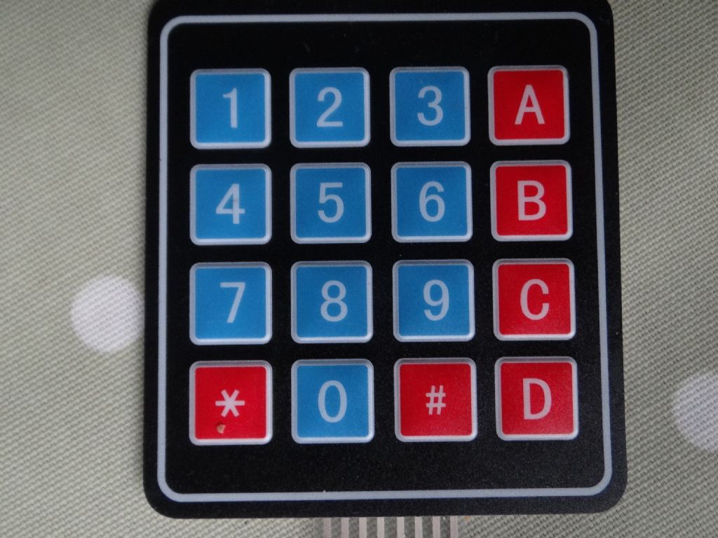

Zebethyal22/02/2017 07:16:36
198 forum posts
Posted by Emgee on 21/02/2017 16:05:07:
John S,
Have you got a link please to the £1-50 keypad for the Arduino, i've seen keypads but not certain they can be used with the Arduino.
Emgee
Here is a link to some Chinese membrane keypads on The Bay, 2 for £0.99 and free shipping.
These, and the press button ones, are simply a 4x4 matrix connected via 8 wires (4 across, 4 down).
If you want a library for simple integration, there is one on the Arduino Playground, or you can write your own code to do the same thing (can make for smaller code, as you do not need to cater for different sized keypads).

Zebethyal22/02/2017 15:02:50
198 forum posts
Posted by Emgee on 22/02/2017 13:19:44:
Posted by Zebethyal on 22/02/2017 07:16:36:
Thanks for the links but those keypads have a 7 pin socket, not 8. I was hoping to just have a plug and play keypad as I have no understanding of programming a sketch for Arduino. I see a 7 pin socket on the UNO and a further set of 9 upward facing pins adjacent to the socket, would the keypad connect to either of these ?
Thanks, Emgee
Just re-checked the picture on the Ebay listing I linked to - it definitely has an 8 pin connector.
Most of the items marked as suitable for use with an Arduino are not plug and play, they are merely something mounted on a PCB, maybe with some extra electronics and a pin header to interface with it. The assumption is that someone is going to write a sketch to make use of it, or combine a number of libraries in a sketch if they don't feel like writing it all from scratch.
I am sure you are aware that the Arduino is merely a microcontroller on a board with no intelligence other than what you upload via a compiled sketch to it - it is in effect a blank canvas.
If you want to have, for example, an LED light up, it makes no difference to the Arduino if it is attached to pin 1, or pin 5, that is your choice, just so long as you tell it, in your scetch, which pin to send the voltage out of in order to light the LED.

The one in your link is a 4x3 matrix so 7 pin socket
Similar 4x4 pads do have 8 pins such as this

My mistake - I meant to link to this one here, same price of £0.99 for 2 but 4x4 matrix.

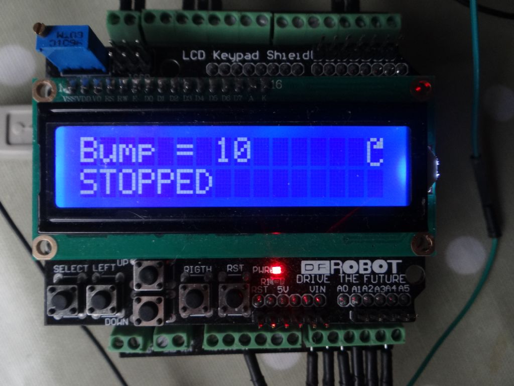

SillyOldDuffer16/03/2017 14:42:24
10668 forum posts
2415 photos
For anyone interested the latest update to my keypad based indexer and a pdf to read are at this Dropbox Link
Using a cheap matrix key pad like this:
It provides the same functions as the Gary Liming's program, but has been extended in various ways. (Mainly the ability to type in numbers, PAUSE, REWIND and control via the USB port.)
  • 'A' sets Angle mode. The angle may be a decimal. eg. 41.75°
  • 'B' sets Bump mode (aka Jog)
  • 'C' sets mode to continuous (ie motor turns until stopped)
  • 'D' sets DivStep mode.
  • '*' starts and stops the motor, abandoning the current operation. (The next operation will continue from the stop position, see '1' and '5' for palliatives.)
  • '0' toggles motor direction between clockwise and anticlockwise
  • '1' rewinds the motor to the start point of the previous operation. Up to 10 previous operations may be rewound.
  • '5' pauses or restarts the current operation, which then completes as normal.
  • '9' enters ratio mode. The ratio may set to any integer value.
  • '#' allows control numbers to be entered, for example to set a required angle, or the bump distance. Numeric entry is ended by typing a second #. In number mode '*' doubles as the decimal point.
The display uses the DFRobot, though it's push buttons are ignored. It is not difficult to substitute a cheaper 1602 display only board or an I2C display. In this example, Bump is selected with 10 steps clockwise. Pressing '*' jogs the motor. A Bump too far may be undone by pressing '1' to REWIND it, which is handy.
When the motor is running a progress countdown is displayed.
If you try this please report any bugs. Although there's been lots of testing it's amazing how the bleeding obvious still slips through!
The pdf includes more examples and the wiring diagram.
