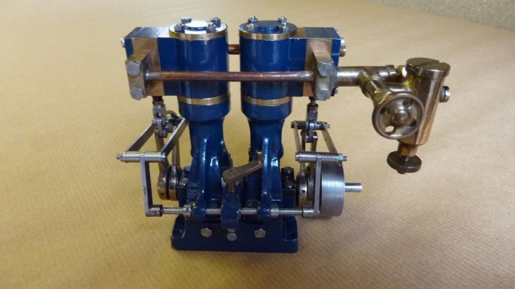

Thread: Who made this?
06/04/2018 13:07:51
Tried to call LAS but no answer and no answerphone - cant find anything like it
06/04/2018 11:36:32
This engine is ont bay - looks good - ium looking for a workhorse to bench mark boiler improvments. Twice the bore and stroke of a D10 if info is correct and has an A cast into valve chest sides - is it a cheap rip off or a legit motor?
**LINK**
