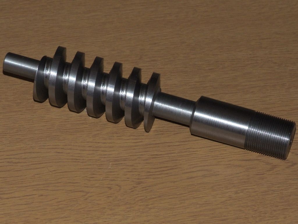

Thread: Milling cutters with screwed shanks
30/01/2022 09:32:40
Don't even think about using a die. The thread should be screwcut for the reasons given by Jason. I use full form insert tooling to get the correct profile. The 1" diameter 20tpi Whitworth thread on this embryo worm wheel was screwcut to fit a large size Clarkson chuck:
Andrew
