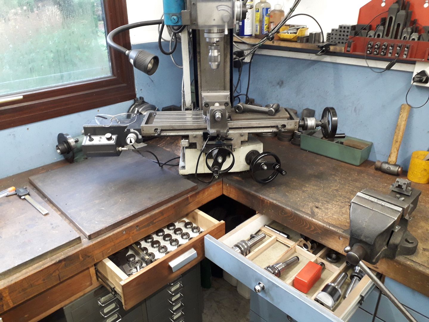

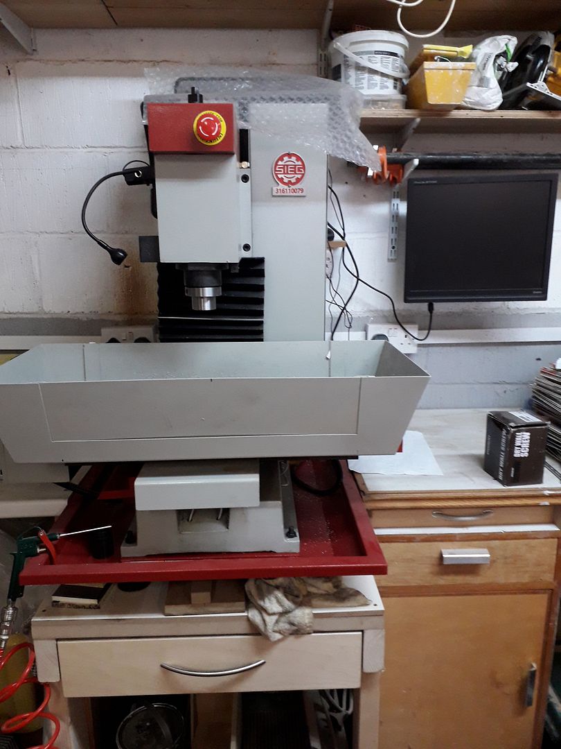

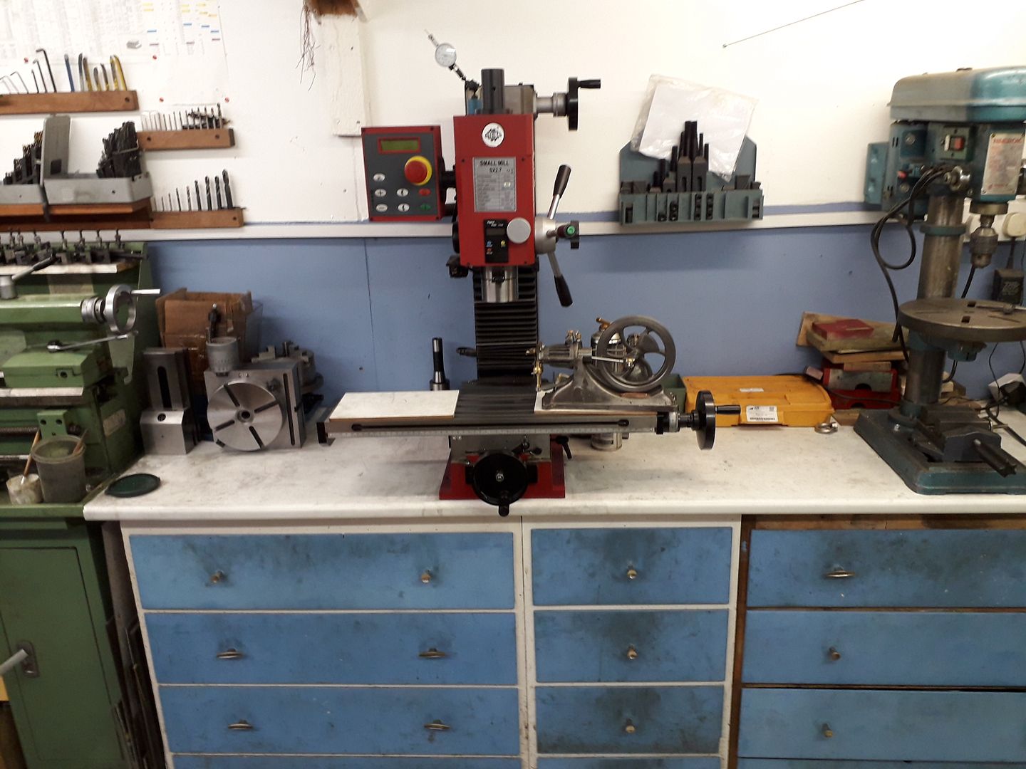

The next procrastination is whether to get the cabinet stand. Looks pricey for not much storage. Does anyone get excited about the stand for their machine and are really pleased they bought it? I'm thinking just putting a back panel and decent top on an old kitchen cabinet...

Not really; two of my mills are floor standing. For the third (CNC) I made my own stand and coolant tank:

John Haine04/02/2022 17:21:56
5563 forum posts
322 photos
I think you need something a bit stouter than an old kitchen cabinet.
John Haine04/02/2022 18:03:01
5563 forum posts
322 photos
My VMB sits on a stand with 3x3 uprights, a top frame of 2x2 with 2 cross braces under the worktop, 2x2 braces half way up side and back legs, double thickness of high quality 3/4 ply for the top. Sides and back further braced with veneered chipboard glued and screwed. The side braces provide convenient ledges for a shelf, and there's a lot of storage underneath as well.
JasonB04/02/2022 18:27:10
avatar
25215 forum posts
3105 photos
1 articles
If you put legs down each corner of the kitchen cabinet and a solid back panel over the lot that should stiffen things up.
My X3 and SX2.7 sit on not much more than carcases with a solid bench over the to that is fixed to a batten along the wall. The KX3 is on a pair of legs fixed to the cabinet at the side with a tick ply top also tied to the wall
