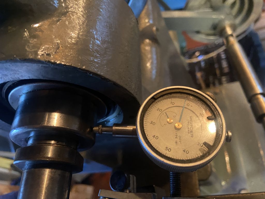

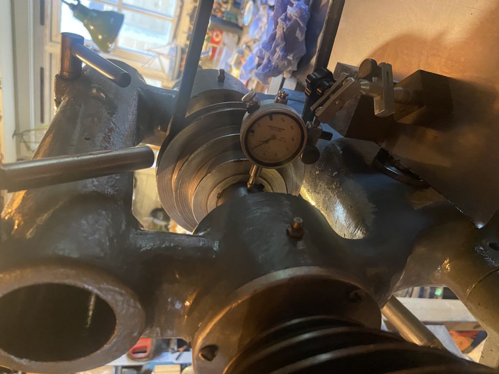

It was inevitable really that the proper fun and games would start once I had got it back together. Any mill manufactured in 1941, with bearings marked 1939 is going to be a challenge.
I have done some test cuts - not too bad but a little chatter and a “throbbing” noise which indicated (I presume) that something is not quite aligned right. I adjusted the belts which improved it somewhat, but it’s still there.

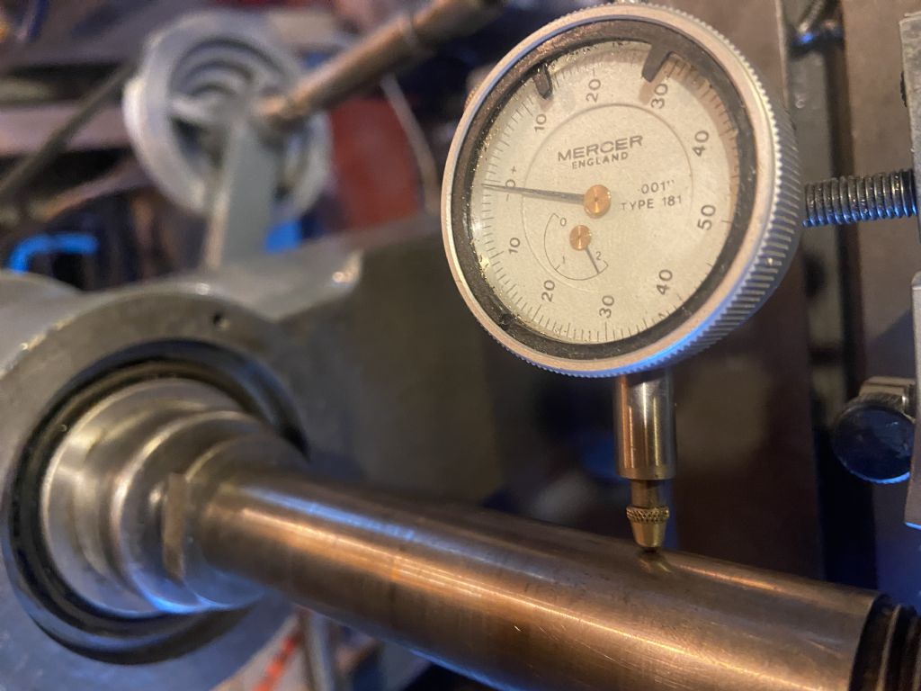

Putting the dial indicator on the spindle I get 0.001 runout.
on the flange (?) of the spindle, I actually get more runout, about 0.00175
But interestingly, on the spindle near the *rear* bearing I seem to get no perceptible runout…
All this seems to indicate that the front bearing isn’t quite seated correctly, or is not adjusted / malfunctioning.
I suppose the spindle could be bent.
I didn’t manage to get the front bearing off when cleaning up the parts. It was well and truly stuck on the spindle and I didn’t want to bash it and risk damaging it. I don’t really know how to remove it.
Spindle out and reseat the front bearing?
I have read Ketan’s advice on preload and heating, that was interesting but I wasn’t sure it was directly relevant to this.
Thanks
Steve
Dave Halford01/01/2022 17:43:44
2536 forum posts
24 photos
What runout does the arbour show?
The drive pullies will show more than 1 thou runout and the belts won't care.
BTW there are some £25 gear cutters out there that have a lot more run out than that.
When you cleaned the bearing did you spin it dry on the shaft? Damaged ones will catch.
Whats the end float on the shaft?

Steve35501/01/2022 17:46:05
321 forum posts
235 photos
Looks like I fixed it, disassembled, cleaned it all up, put it back together very carefully. Now I’m getting less that 0.0005 runout at the spindle, which is probably surface imperfections.
The mill still makes a throbbing noise though, but the surface finish looks a lot better.
