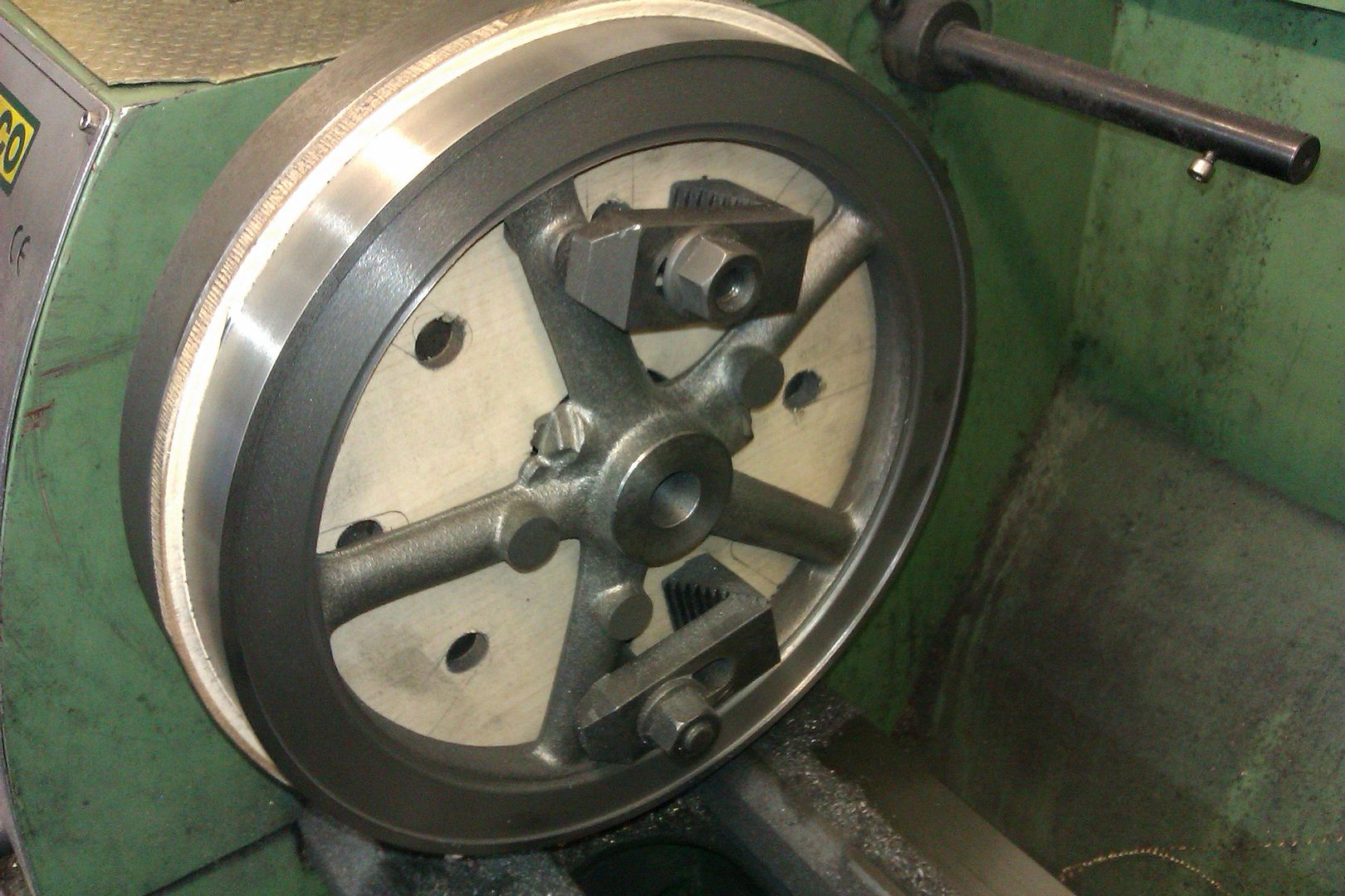

When I machine a flywheel I set it up on a faceplate so I can machine one side of the rim and boss, the bore and the rim at one setting. That only leaves one side to get the rim and boss to width. The flywheel doesn't need to run true to do that, which simplifies mounting on the faceplate.

Posted by Bazyle on 05/02/2022 09:40:26:
On a faceplate do you pack it off the surface at the spokes or rim?
Rim; one can see the aluminium blocks, bolted to the faceplate, in this picture:
Note the four steel spigots bolted to the faceplate. These provide the drive to the flywheel, and radial location. The clamps on the spokes do not need to be more than nipped up. They are there to stop the flywheel falling off the faceplate.
Andrew

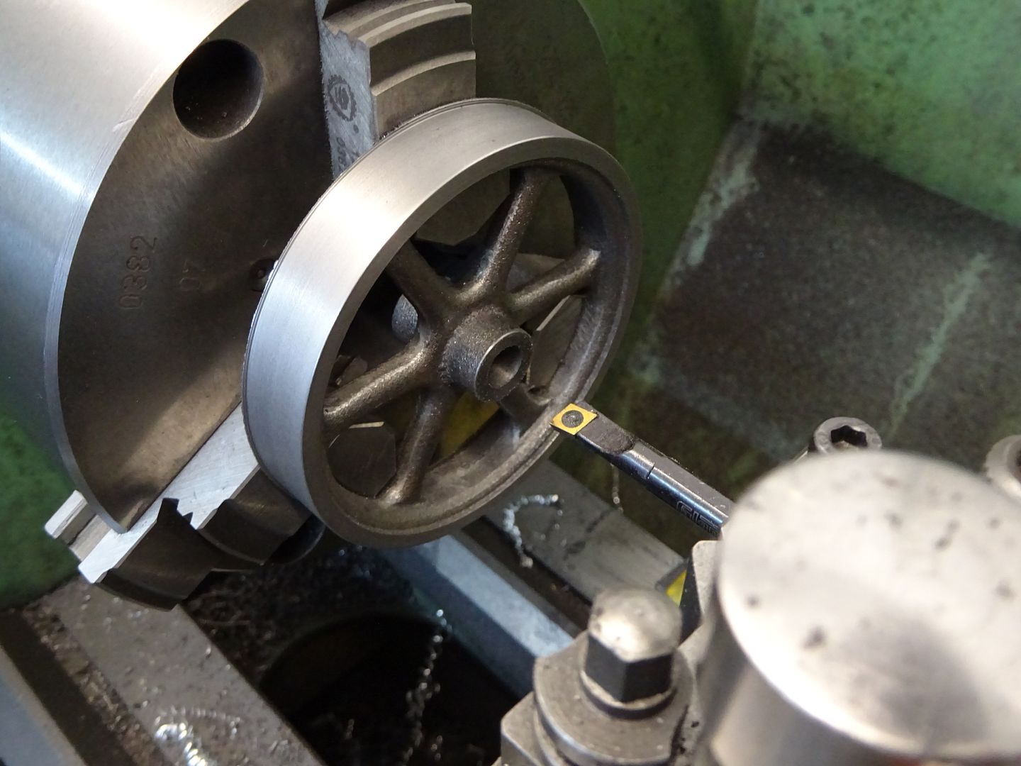

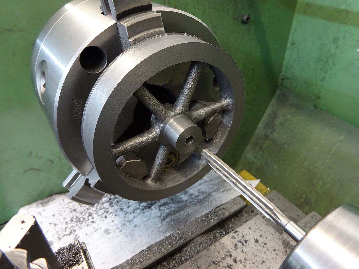

Indeed Ramon as I said I tend to use the chuck mostly but a question was asked about cutting into the faceplate. Also depends on the lathe being used, when I did my 10V on the Unimat 3 it had to go onto the faceplate. The other thing to consider is if it is a variable speed lathe then they are better run faster than a Myford as they suffer on larger diameters with no backgear.
Couple of 10V size flywheels in the chuck for good measure
Regarding the hole, I always try to bore it unless very small eg 6mm or less.. A drill can wander particularly if it hits a hard spot or void in a casting and the reamer will follow the wonky path. I also find I can get a better fit by reaming as I tend to only have 1 reamer for each nominal size so don't want as loose a fit as I would in a bearing.

JasonB's post explains the reasons for boring rather than drilling. A compromise approach is to start the mouth of the hole to diameter with a boring tool and follow up with D bit or drill; this method can be useful for small holes where the available boring tool is too big to bore to full depth.
