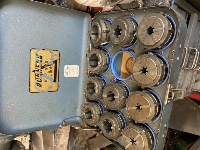

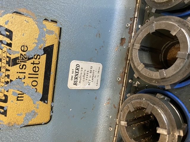

03/08/2021 16:12:18
Mr Noo
theres only the size written on each collet
nothing as far as i can see on the chuck
03/08/2021 12:48:13
83145873-aa85-4ea7-b071-a4d75ab38f95.jpeg5107c079-3b7f-490a-8b11-751b789564ac.jpegThese are what you want
