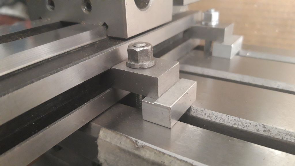

24/03/2021 14:21:52
I had the same problem with clamps denting the table, so I made these in the pic, they are little aluminium blocks machined to the same height as the vice slots, the steel top clamp can be bolted down spreading the load evenly. It'll do until I make better looking one piece clamps.
Weirdly this is a new cast iron longer table which dents easily, softer than aluminium! the old smaller cast iron table didn't dent at all, must be made of tougher stuff!
