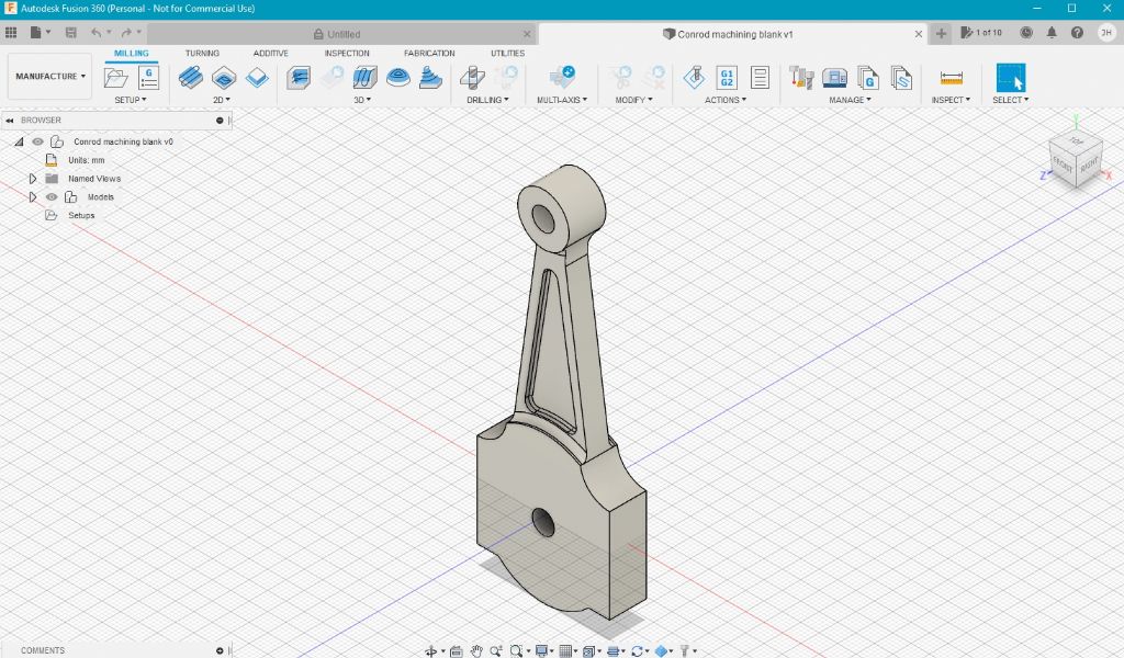

I followed Jason's link and watched the first 3 videos in the series and very informative they were. Suitably inspired, I downloaded Fusion and set about having a bash at one of my Alibre files. I managed to load a STEP file of a conrod blank into it and it looked similar to the set up that Lars has in his videos. The part is placed correctly on the three planes but the orientation is not to my liking. No matter what combination of mouse clicks and swirls I make, I am unable to manipulate the part such that it is in a isometric-type view. This is what the screen looks like:
First Fusion view
Fortunately, due to the lockdown restrictions, my hair has grown considerably, so I have plenty to pull out, but before I do, can anyone (Jason?) tell me what I'm doing (or not doing) wrong, please?

Place the mouse over the little isometric cube top right and then hold down left button and move the mouse which will allow you to move the image about in all planes.
Once you have it where you want it put mouse back over cube and a little house will appear, right click that and from the box that appears move down to "set current view as home" and you then get two options, I would suggest moving to "fit to view" and right clicking that.
You can now just move mouse to cube, home will appear and click that to always take it back to the view you want after moving it about.
You can also click on any of the corners of that cube that become blue as your mouse is over it which will give several iso views from different angles. You can also click a face and than assign which is the top etc.

John Hinkley13/04/2021 10:44:56
avatar
1545 forum posts
484 photos
Once again, Jason to the rescue! Do you wear a cape and your underpants on the outside, I wonder?
I tried all the above and, of course, it worked. Perhaps I should have invested a little more time trying to get to know the foibles of the basic Fusion package. But I'm too impatient.
