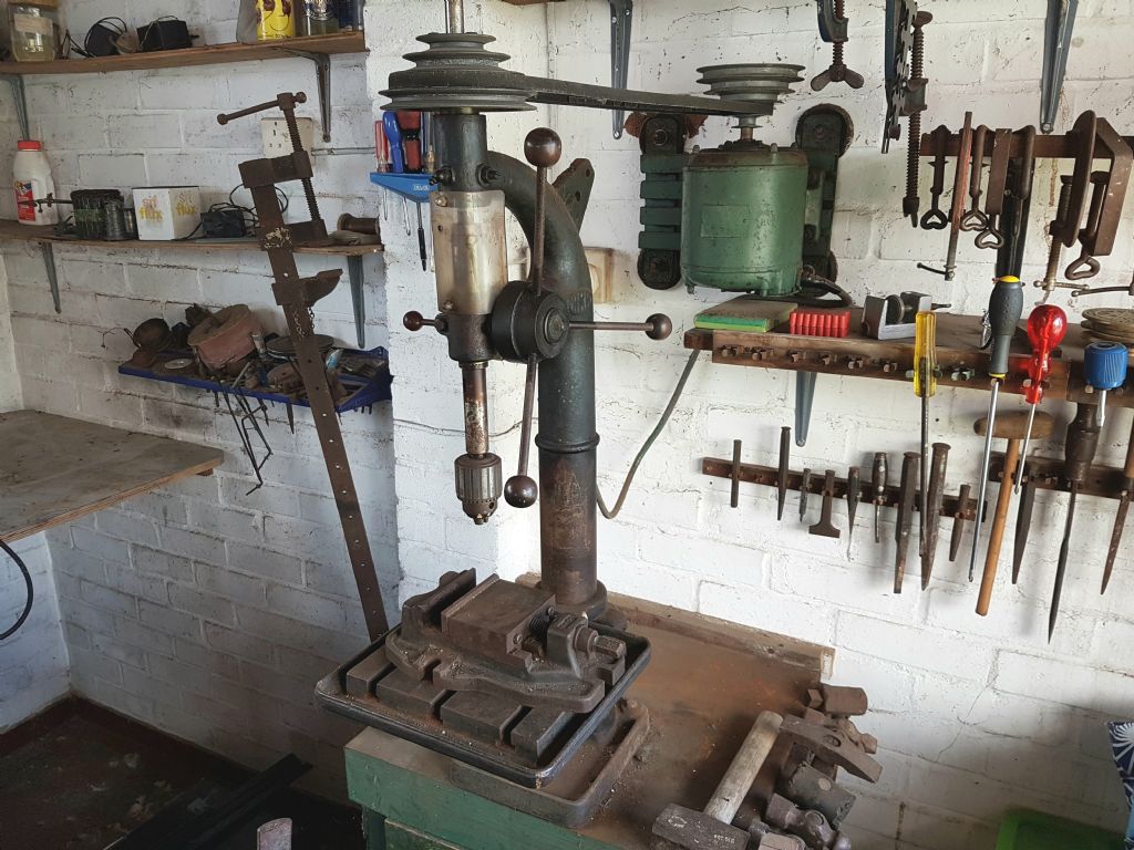

I think the SX1LP would do fine. The last drill was a really old bench mounted pillar one (40’s or 50’s) with a huge wall mounted washing machine motor. Used it for thirty years at my previous house. Plenty of power and the drill would turn in the chuck if working hard.
Had to sell due to moving and space hence looking at what’s available now. Will need to read up a bit more on the spindle type but it’ll be used mostly for drilling.

Dan Reavey05/06/2021 10:59:18
20 forum posts
5 photos
Yes, possibly a floor mounted drill. Saw one briefly in MachineMart the other day. Looked good value.
My old pillar drill:
Dan Reavey05/06/2021 13:25:18
20 forum posts
5 photos
Posted by not done it yet on 05/06/2021 10:37:39:
You likely need a floor mounted pillar drill for drilling ‘large’ pieces. A small mill will only drill so far from the column and the height restriction can also be a limiting factor. But depends on what you call large, I suppose...
Thanks. Beginning to think I’d do better with a pillar drill. It’s what I've always used and could offer most stuff up to it.
Easier to position too.
My local MachineMart has one:
**LINK**
not done it yet05/06/2021 18:52:42
7517 forum posts
20 photos
The chuck to column on that machine is only 162mm, so not exactly over-large but may be enough for your ‘larger’ items. The vertical axis is clearly much less restrained.🙂 Again, check for the real motor output, but it may well be adequately powered. You cannot mill (safely) on a drilling machine, of course.
