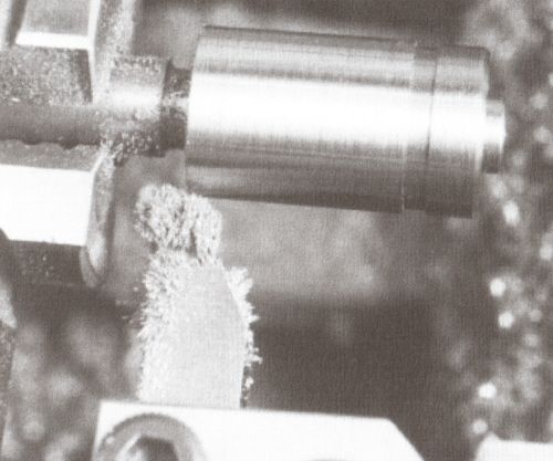

02/10/2014 20:21:40
Thanks Jack for purchasing the book, I do hope you will find it useful.
Regarding the gauges, I would not suggest they serve no purpose but as far as the book is concerned they are there to provide exercises in working to very close diameters and lengths.
For me, I only used the hole gauges very occasionally, that is when I need to get a hole diameter as close as I can to the gauge diameter. To do this, I set my top slide at about half a degree off of parallel with the lathes axis so that a 10 thou feed of the top slide will result in radial movement (depth of cut) of nominally 1/10th of a thou.
By this method I can take very shallow cuts as I arrive near to the required diameter for the bore, doing this until the gauge just enters the hole. Of course the tool has to be honed to a very fine edge for these depths of cut to be taken. You do also need to clean the hole completely to make the test.
This is basically the method I use in the book to arrive at very precise diameters and lengths. The following, scanned from the book, shows a round nose tool that has become magnetised and producing swarf almost like grinding dust. It shows a hole gauge being made with a chamfered leading edge to give early warning that one is approaching the required diameter and then a very slightly reduced diameter to show you are very close.
The distance gauges however I make considerable use of, typically for setting my saddle stop as can be seen by photos 1 and 2 here
