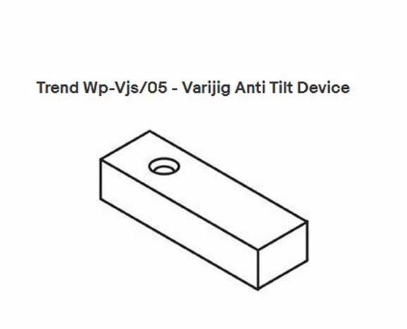

Hi all.
We have just bought a load of almost new tools by VERITAS of Canada, all in lovely condition.
They include a VARIJIG adjustable system for routers etc.
There is one small very simple item missing which is called an anti-tilt block
I was wondering if anyone has one of these could I please have the dimensions so I can knock one up?
Cheers, Martin

Hi Martin,
I don't have this particular jig, but I think the block will be the same thickness as the frame, other dimensions not critical. I guess it is screwed to router base to stop router tipping over, when balancing on the narrow frame.
I just stick a suitable block of wood on the base with double sided tape, when using home made jigs.

I will make up a small alloy block with a suitable thread and put that with the jig.

I think it will be the same thickness as the frame plus the thickness of the part of the template guide that rests on top of the frame.

**LINK**
£3.90 from Trend Direct.

Hi again,
Trend Router Bases are tapped M6, so you only need a clearance hole and counterbore.
Plastic/Nylon/Wood would also be ok to use. The Trend one is probably plastic, so it won't mark the job.
For Reference the piece in this picture is 70mm long x 20mm wide.
The Guide Bushes are flush with the router base, so don't add anything to the thickness of the jig.
