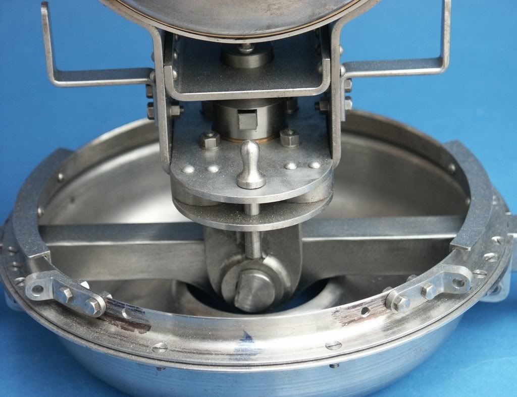

To fabricate you can take 3/16" strip, bend to your radius. Then rest the bent strips on edge onto some 1/16" plate and silver solder. Its then just a case of cutting them out and trimming the leg to a constant 1/4". Thats how I did the two angles above the axle here.
