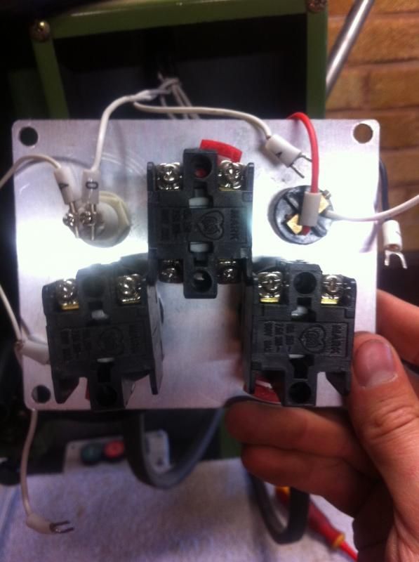

Hello,

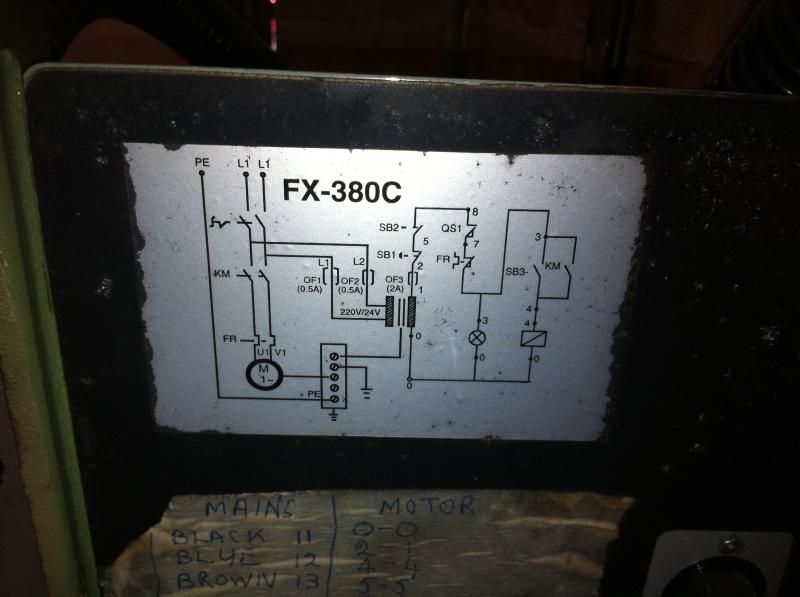

I am hoping someone can help me please. I have a Warco Major mill/drill MD30B and while trying to fault find too the switch wiring apart without taking a photo crying I also have 2 wiring diagrams and neither make sense to me with the numbered wires to the switches.
The pictures show the wiring diagram in the back of the mill and my switch panel. the wires are as follows. Red:7 Balck:8 White: 0,2,3, Two 4’s one has three connections, 5,6 and another 8.
if someone has a Warco Major Mill/Drill and would mind taking a picture of there switch wiring that would be amazing. or could explain the sequence. Any help would be greatly appreciated as at the moment i can't use it at all...

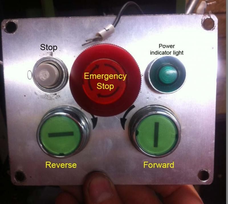

Can you describe the button panel, EM stop with light to right and power on to left, you dont have reverse on the motor so what do the green buttons do.

Twist emergency stop to release and engage power so the light is on, the lower green buttons are forward and reverse, the white button top left is normal stop.

then the diagram you are showing doesnt show FWD or Reverse

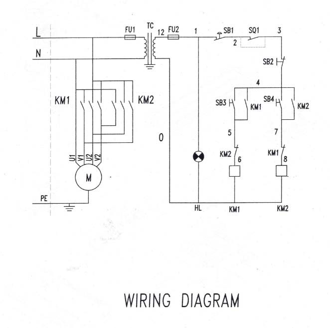

that diagram in in the back of the mill, i have another which is this.

The drawing is self explanatory, based on what you have shown so far SQ1 is an option, I think, as you only have shown four buttons, KM1 and KM2 are the coils for the motor contacts, SB3/SB4 are the FWD/REV buttons, SB1 is the EM stop and SB2 is the stop button,FU1 and FU2 are fuses and the quartered circle is the lamp, connect your numbered wires upto the various listed parts.

Ok, but i dont have a wire labeled 1 to go to my EM stop button. I have a 4 wire with three terminals starting at the light and then another singe 4 wire.
Sorry to be so thick! i just cant get my head around it.

do you have a wire from the light and a wire from the fuse, if yes put these into one side of the EM stop or seek an electrician that can do it for you.

Looking at the diagram that you have labelled "that diagram in in the back of the mill" (Which must be the correct one as the other does not support motor reversal.) I think you should have five wires (And possibly an earth) from where ever the transformer, fuse and the two contactors are located. can you confirm if this is correct and if so how are they labelled ? Also do you have a multimeter ? Even I would always make a note or take a photograph of connections before removing them to save the effort of tracing the wiring. I agree with Martin's comment that you see help from someone with some electrical knowledge. Ii is very much easier to sort things like this out when you have access to the machine. This is another case where a profile might help solve the problem quickly.

I have just read through the thread again and the statement "Twist emergency stop to release and engage power so the light is on" would suggest that the mill is not wired in quite the same way as the second diagram suggests. It suggests that the top wire from the indicator lamp connects after the emergency stop button. This means that it may be connected to point 2, 3, or 4 rather than point 1 as shown in the diagram. If connected as the diagram it would remain on even when the emergency stop button was pressed in.
