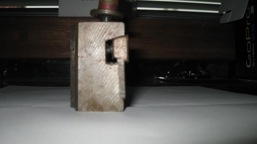

HI, I have a Boxford lathe with a T0 size Dickson tool holder set up. When I put a blade in the part off tool holder the blade tips over at the top. I'm thinking I may need the correct type of part off blade as the one I have at the minute is rectangular in section?
Here is a pic, excuse the quality of the photo but I think you can see the problem. Any advice appreciated.

Hi Scott, you could be right about the cross section but just a thought. You haven't just got a holder for a rear tool post with the blade upside down have you? Cant remember off hand what mine looks like.

Forget my suggestion just now. Had a look at the Myford page and the wedging strip is on the bottom for rear tool post. I do remember that my parting blades are wedge shaped in profile though.

I think you need a blade with a trapezium X-section, i.e. an opposite bevel along both edges.
The 1/2" blade in my Myford-Dickson holder has the bevel edges: the holder is made for that type, presumably the same though might be a different height blade
Parting blades with right angled edges are rare in my experience: However the tiny 5/16" blade in my special Dickson rear tool post holder is T-shaped with a very narrow top to the tee, to give side clearance when cutting, and has no bevels. (Blades of this type are very difficult to find)

Thanks for the replies folks, very helpful. Tony, I think you are correct that I need a trapezium section parting blade, do you know where these can be sourced from?

Both holder and blade have been bodged to make incorrect components go together.
The clamping wedge should be essentially symmetrical in shape and of a size such that when fully tightened with no blade inserted so the back of wedge and slot are in contact the lower wedge angle should almost contact the bottom corner of the slot. Clerance is thou's. Just enough to be sure there is no contact there when attempting to clamp the blade. The screw holes are a little above centre line. As I found out when making a stepped wedge to let my T2 size take next size down blades to use up my stash.
Blade should be narrower at bottom than top. Bottom edge should sit neatly in the toolpost groove, top edge angle should match the wedge angle. Top is fairly rough ground. presumably to ensure that folks aren't tempted to use the blade as is instead of grinding top flat on the projecting portion. For proper clearance in the cut slot when parting off the top must be ground back at leas as far as the maximum extension you plan use. I've never seen any need to angle the top or apply backrake. Continous coolant / lubrication whether by flood or mist seems best answer to parting problems.
With the correct size blade fitted the back of the clamping wedge should be very close to the back of the slot.

Hi Scot, It will pay dividends in the long term to buy a genuine Eclipse blade, Dickson tool holders were designed for these. Yes they are expensive compared to the clones but they do WORK and that's what matters. I have tried the clones and frankly they are hopeless by comparison.
Moral don't economise on tooling you will pay more if you do.
