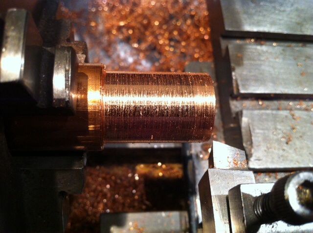

image.jpgHello all.
Been turning some copper sleeves today, no problems until I came to turn the last one tonight,
When I came back to the machine to start the last one, touched the tool on the grinder to restore the edge, same as I have done many times before but the finish is awful, material just tearing away,
Machine is a myford 7
thank you for any advice you could offer.

tool looks fine for copper but think the side cutting angle should be much less ie negative instead of positive, and less end cutting angle. hope this makes sense.

It looks like you are using only the extreme point of the tool. ... If you have literally only "restored the edge" then the basic shape should be right [it worked before]; so I would first try moving the tool a couple of degrees anti-clockwise [as viewed in your photo] ... the cutting action needs to be "slicing".
The other possibility is that the tool is now a few thou' low, and is digging-in a little.

First thing is you have no nose radius, you are cutting with a sharp corner so you will get tram lines.
Next thing is and I'm going to get slaughtered for this is I reckon all the books are wrong on copper. They always say no top rake or 5 degrees max but years ago I used to make laser cutting nozzles, that many I even bought a brand new Myford C7 capstan to do them on.
Getting these right was a steep learning curve to be fast and make money. Two things I found really helped and none was in any books.
First the top rake was ground at 30 degrees, side rake was 5 to 10 and the edge had a radius honed on.
Second I ran on neat soluble oil, no water added at all and within a few hours this oil had turned green from the copper.
That job and lathe has long gone but I might still have some tools left as I used to grind a few up at a time so if needed it was only a tool change and not wait to regrind. I'll look tomorrow.

You just can not have the tool too sharp to cut cooper. It does need a nose radius unless you want to feed it very fine. Some grades of HSS just do not hold as sharp an edge as others. Just like some grades of carbide do not hold a sharp edge. Using a fine hone stone makes a very big difference when turning soft materials.
Making a guide up so the stone is not rocked as the edge is being honed is also a big help in getting the tool sharp. When you look under a powerful loupe at the cutting edge you will see the various marks from grinding and the hone. Getting it as fine a finish and smooth makes all the difference. It should look shiny to the naked eye.
They now make carbide inserts with very high positive rakes for copper, and they are very shiny on the surface finish, and expensive.
Vege oil like canola or olive oil works very well with most materials including copper.
When everything is right, you do not need it to be going really fast to get a good surface finish.

After regrindQuick thank you to everyone.
Ground the tool as instructed in the link supplied by Michael, did the trick a treat.
must have been a lot more heavy handed than I thought.
