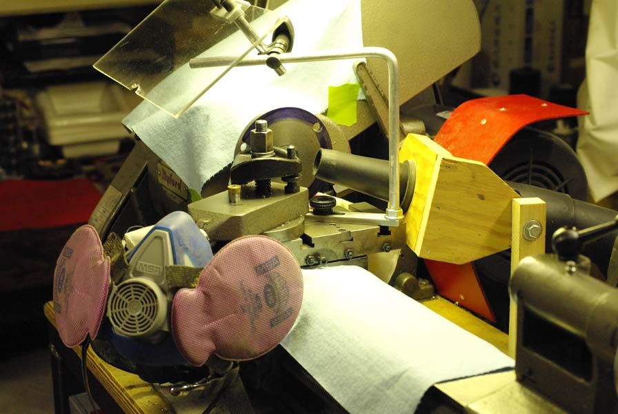

Nick
This may be of interest to you. I constructed the adjustable plywood bracket that clamps to the rear of my lathe bench. A hole accommodates a tapered Shop Vac Nozzle that can be maneuvered close to the work. Cuts the airborne dust down significantly.
Bill

Don't be tempted to do what one of the guys on Traction Talk did. He set up an extractor fan in his workshop wall and spent a happy couple of weeks machining bits for his engine over the summer. Unfortunately the first time it rained every horizontal surface at the back of his and next doors house turned a nice shade of orange/brown, the window cills were the worst crying
