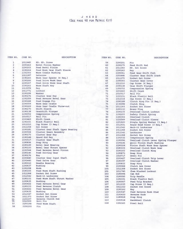

As John says but some Bridgeports have a slightly longer screw (165) holding the quill stop knob on (163), if the spindle drops a short distance then stops solid it's probably caught on this, no great shakes it just means taking out the quill stop screw (164) and the stop, put a bit of timber underneath it as it can come out quick.

You will be OK nothing else will drop off, the quill skirt is held on the quill by a couple of screws which you access from the top after taking the head off.
As you only taking out the spindle this will not be affected.
When disassembling the quill stop screw assembly what you may find and it’s quite common is the reverse trip ball lever is broken, all it takes is for the quill stop screw circlip to pop and the screw drops snapping the ball lever off, getting the remains out can sometimes be a pig.
