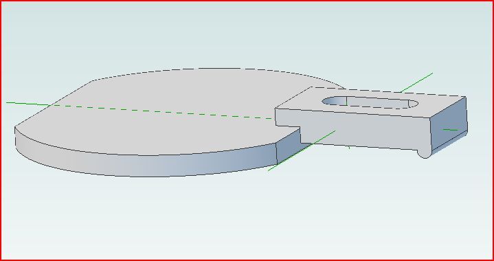

A couple of photographs of the actual vice.

JasonB14/10/2013 18:45:02
avatar
25215 forum posts
3105 photos
1 articles
You could still just make a couple of clamps to hold what you have left, the remaining lug would be like the bottom of a groove and no loss of head height
If you do still want a separate plate then I would have a large Csk screw in teh existing hole and tap the base to take another M6 fixing at either side. The three together should be firm.
Edited By JasonB on 14/10/2013 18:47:25
Oompa Lumpa14/10/2013 18:54:12
888 forum posts
36 photos
Jason, thank you. Sometimes you get tunnel vision and for the lfe of me I couldn't see this. I will set to and make some clamps as per your drawing.
I appreciate the guidance.
