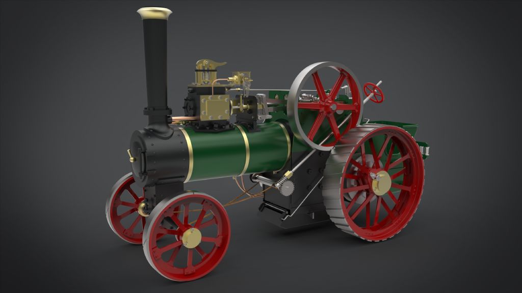

Paul Lousick26/12/2020 22:02:00
2276 forum posts
801 photos
For anyone interested, there are 3D models of a 1" Minnie on Grabcad.com, available for download in Solidworks, step and igs formats.

That's very helpful Paul. I always like some 3D to help me understand a part.

There was something about a missing dimension on the winding drum ratchet and the forward reverse quadrant was wrong. The quadrant positions depend on 'your build' and the ratchet can be worked out anyway.
The book holds more detail in the words than that shown on the drawings, drill sizes for ME threads and shaft bearing oiler drain hole sizes etc.
