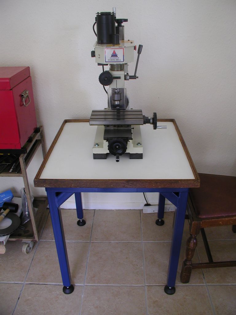

I have completed my mini mill stand this weekend and would like all you guys to see some photos of it.

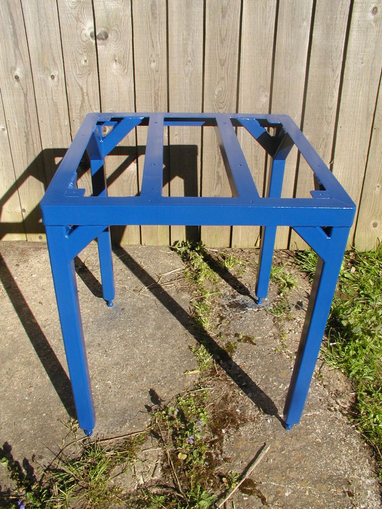

Apart from the machine mounts, the paint and the bolts that hold the mill down, every part of it was free. The legs are made from used 40 X 40 X 2mm box which I aquired from a job modification last year that a work colleague and myself did last year. The angle iron frame that holds the top on was given to me by a neighbour who moved away a few years ago.

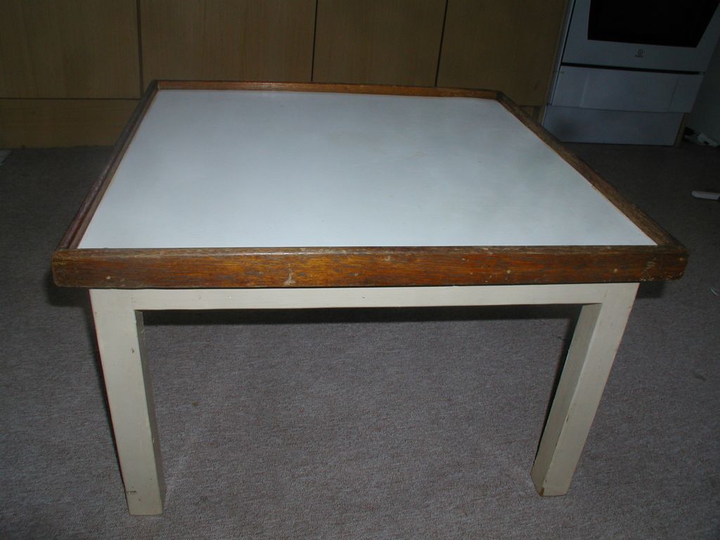

The top was from a makeshift coffee table that I used some time ago when funds were not able to buy one.
The Top
This I got from my old employment many many years ago which was part of a taller stand for a two way radio system. The legs were removed to leave just the upper board.

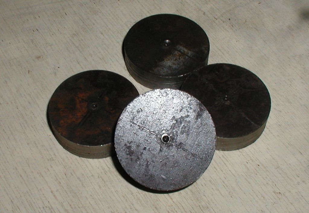

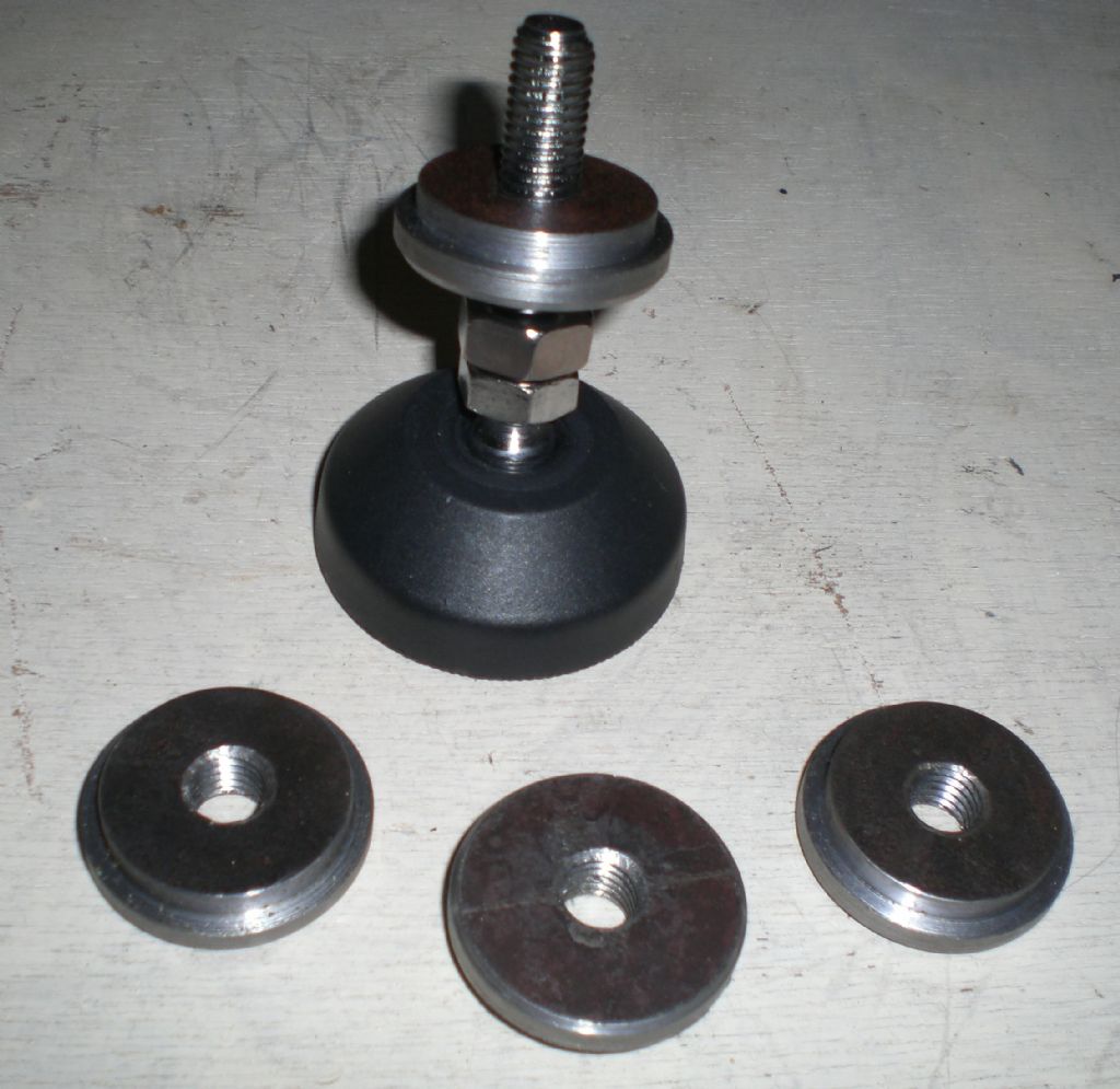

Four waste bits about 11mm thick from a heavy section of channel iron, which I cut out with a 50mm rotor broach on a job a work a couple of months ago were used in the bottom of the box section legs were drilled and threaded for the machine mounts.
Machine Mount Blanks
Machine Mount Blanks 2
Here is a photo of the frame when it was painted.
Paint Job

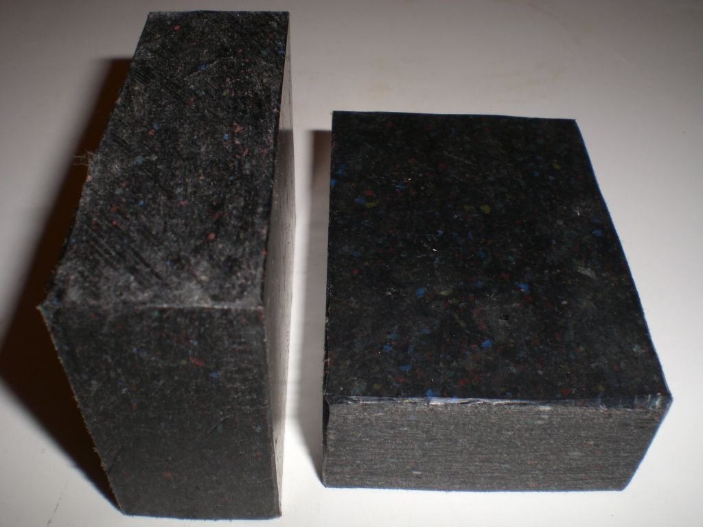

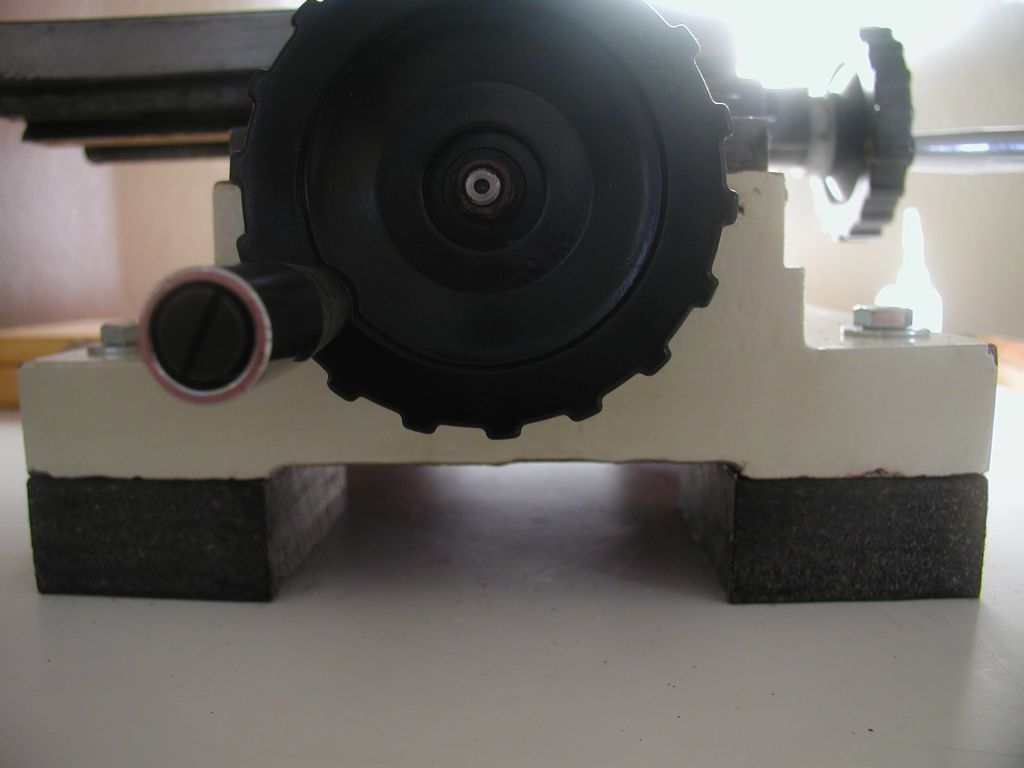

Four raising blocks were made from high abrasion risitant plastic. This was an off cut from 28mm sheet when I used to work for my old employer, which were used as replacment liner plates in their Attrition Scrubbers, (nothing to do with red light areas or domestic servents) for those who are interested in knowing about attriction scrubbers look at this http://www.floatex.co.uk/brochures/Floatex%20Scrubber.pdf the first photo is of the two banks are the actual ones that my then colleagues and myself used to maintain.
Rasing Blocks

The final stand was designed to be used sitting down, but it's not to low to be used standing for short periods.

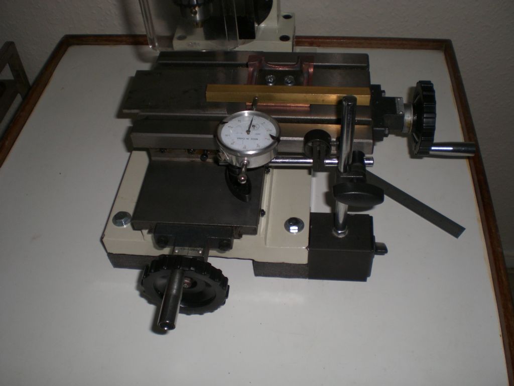

Michael the footprint was predomently chosen by the fact that from the start I intended to be able to sit at the machine with my legs underneth without being sqashed in, the top being large enough for this to be achieved. I agree with you, that being able to get access all round is a big advantage, as measuring from the back is so much easyer. Being able to clean around the floor area without having to move the machine, makes it so simple with this design.
Setting Up
Setting up this little casting was such a easy option being able get to the right hand side.

Peter your set up sounds pretty sturdy, I never made any calculations for my stand, but I guess being experienced in fabrication and welding in my line of work it becomes a secound nature.
Thor, the machine mounts were purchased from Warco, no connection with them. http://www.warco.co.uk/machine-mounts--guards/302787-machine-mounts.html

I needed to be able to move it, hence a wheeled trolley. The trolley is steel with a top and bottom shelf, both with lips and not really thick enough to be strong enough. Also the Y handwheel is too low if the machine is just set on a bench (hand catches on the bench). Hence the 40mm of wood to help strengthen the top shelf and the long spacers to get the machine high enough to give clearance for the hands.

Hi Peter, my stand was largely made with the same "what have I got that Might do" basis and my plastic raising blocks do the same as your long spacers, because as you say to give clearance for my hand to work the Y handle without scraping my knuckles.
Raising Blocks 2
