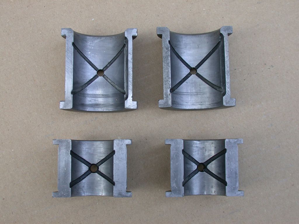

Too much oil is better than too little, although messy. What you want to do is flood the headstock bearings when you start up, then reduce the flow as you keep working. Don't forget the bearing will warm up as you use the machine, and alter the clearances.
The white metal bearings in which the spindle runs have grooves in them which retain some oil - will do a pic if I can dig out some spare bearings I have.
Phil.

Robbo10/04/2013 14:11:30
1504 forum posts
142 photos
As promised earlier, picture of ML7 headstock bearing shells, for those who've never removed the spindle.
Phil
marqous basu14/04/2013 21:59:32
4 forum posts
Oh, I see, thanks for the pic.
