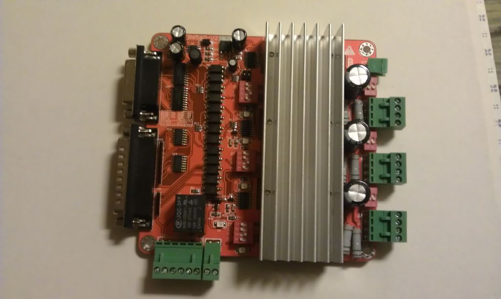

Hi
Have come across a stepper motor driver cards, TB6560-V2, a red card.
I need now is a schedule on the coupling of motors, PC and hand control.
Have searched on Google but only found diagrams of the blue card.
Is there anyone here who has a schedule?

Bertil,
Sorry but saying red card is not specif enought.
There are two cards out there, both with the TB6560 chips on and both red.
One has just a single parallel port socket and one has the parallel port socket with a serial port to the side of it.
Both red but both different animals. Any chance of a picture or link ?
If you haven't bought this then a word of warning to only operate these at 20 to 24 volts MAX as they easily burn out. they are not the best cards on the market.

This is the controller card.
TB6560 controller

Olaf19/03/2013 22:38:03
2 forum posts
Hello,
i do own the same red Controller card TB6560 V2 as on the picture from Svarven. And i do need some more information too (DIP Switches, PINOUT).
Do anyone hase any further Informations about the board?
Thanks in Advance!
Greetings
Olaf
Olaf23/03/2013 13:35:26
2 forum posts
I the meantime i have got some more Informations.
FYI
Control signal interface
PIN Func Explain
1 EN Enable control signal
2 STEPX X Pulse signal
3 DIRX X Direction signal
4 STEPY Y Pulse signal
5 DIRY Y Direction signal
6 STEPZ Z Pulse signal
7 DIRZ Z Direction signal 18-25 GND GND
10 L1 Input limit interface 1
11 L2 Input limit interface 2
12 L3 Input limit interface 3
13 L4 Input limit interface 4
14 RLY Relay control signal
15 L5 Input limit interface 5
18 GND GND
19 GND GND
20 GND GND
21 GND GND
22 GND GND
23 GND GND
24 GND GND
25 GND GND
The drive using six DIP switch to setting current, segments, decay Mode
The current is better to closed to the motor rated current.
T1 T2 current
ON ON 20%*3.5A
OFF ON 50%*3.5A
ON OFF 75%*3.5A
OFF OFF 100%*3.5A
Segments Settings
When M1 = off, M2 = off, drive segments number is 1,1.8 ? step angle motor turning circle, the whole step = 200 steps / rev. When M1= OFF, S4 = ON,1.8 ? step angle motor turning circle, the whole step = 3200 steps / rev.
M1 M2 Segments
ON ON 1/8
OFF ON 1/16
ON OFF 1/2
OFF OFF 1
Decay Mode
Rapid decay is better when motor has a high speed.
D1 D2 Decay Mode
ON ON Rapid decay
OFF ON 50%Rapid decay
ON OFF 25%Rapid decay
OFF OFF Slow decay
Royston01/04/2013 16:48:12
1 forum posts
Hi
This is my first post but my be of help.
I have the same card, I am running mach3 on XP, my pin/port settings are:-
Motor output
X axis, enabled, step pin 2, dir pin 3, dir low x, step low y.
y axis, enabled, step pin 4, dir pin 5, dir low x, step low y.
z axis, enabled, step pin 6, dir pin 7, dir low x, sep low y.
Card dip settings :-
All three axis are the same
D1 on
D2 on
M1 on
M2 on
T1 on
T2 off
The three motors work ok.
I need help with the relay output. The relay light comes on with some settings when Mach3 is 'Reset' and goes out with other settings but I am unable to get any output from the terminals.
