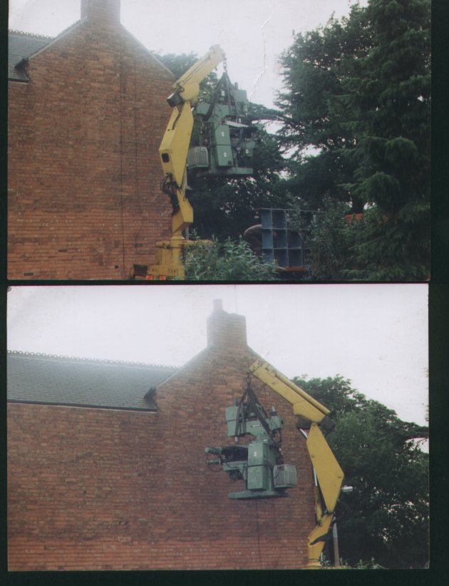

Pictures speak a thousand words. A great morning, a lot less hassle than I thought and takes up less space too.
My mill is now in position, I've started to give her a clean as its sat unused for 15years.
So far, given a slight clean, worked out the one shot lube system.
So my list of questions are as follows.
Should I repaint it? or is it not worth it?
Slides are strangley free in all axis, anything else I should do before using?
Its a 2hp 380-440v motor, I've got headaches working out what to do to power her. Suggestions welcome!? Its also got a powered slide and coolant pump.
I need to wire her back up, where can I get a few replacement switches etc from?
Any way to date her? Its got a door on the side of the base, with a 4 digit number, the head has 5 digits. I do know a bit of history for the machine.
Does it need bolting down?
Tooling, new vice or old? Would a r8 er32 chuck be a sensible idea?
Moving Knee- makes a slight grumble going up and down, doesn't seem like an issue to me, should it be smooth as a babies bottom?
Really sorry for all the questions! Bit of an excited boy here

John Stevenson10/02/2013 22:46:47
avatar
5068 forum posts
3 photos
Don't paint it - use it.
Last two numbers on the door are the year. It's an old one 1968 ? because it has the older mechanical power feed which IMHO is far better than the electronic type that used to masquerade as a one bar electric fire
They will run off a single phase inverter, wiring is on the terminal block, wire for low voltage. You have the step speed head which with an inverter is a far, far better piece of gear than the varispeed head.
Don't bother bolting down, not worth it, just make certain it doesn't rock.
Knee's do suffer on these because of the over balance weight, get plenty of oil into it and work it up and down.
jason spencer10/02/2013 23:06:14
72 forum posts
Yep, 1968, also found the plate on the inside of the door that has the month also. Think i'm just going to give her a good clean and leave it. It came via carlin motorsport who themselves purchased the equipment from brabhams f1 when they bought the redundant equipment after they ceased trading. I guess it might have some F1 swarf in it!
The knee isn't stiff, just a little grumbly.
I was hoping it could be wired for 240v 3 phase as the inverters are cheaper however I can't see that it can be? the terminal block inside the switch cover is a little on the confusing side.
Regarding the power feed, it is an earlier one(6f?) however I seem to be missing the speed change handle...... Another thing on the list or would I be dreaming If I thought I could get hold of one?
John Stevenson10/02/2013 23:46:54
avatar
5068 forum posts
3 photos
Yes they can be provided it's not the rare two speed. By two speed that means it has 5 positions on the switch.
If it has 3 positions then it can run OK off an inverter. If all else fails it's a doddle to bung a decent 3hp motor on it instead of those stupid 60 Hz yankee toasers.
I can ask and see if the guy I deal with, midlands Bridgy engineer has any spares for the 6F unit?
BTW nice pic of the delivery but this is a flying Beaver <BG> wink
