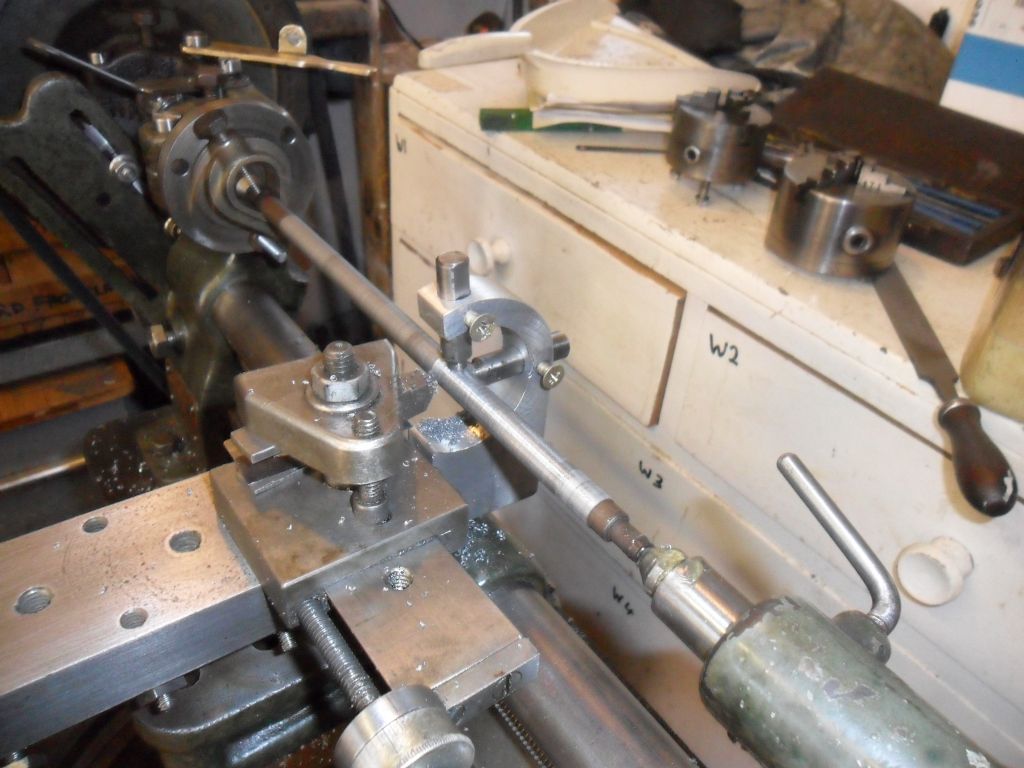

Flying Fifer13/12/2012 22:48:52
180 forum posts
Brian,
Any chance of posting a picture or two?? I always think a photo tends to be better than words. It sounds just the kind of thing I`ve been thinking about for sometime.thinking
Regards Alan
Edited By Flying Fifer on 13/12/2012 22:49:29
KWIL13/12/2012 22:57:08
3681 forum posts
70 photos
Taper Turning
You mean something like this? Silver Steel guide bar with PB lined slider connected to the cross slide.
