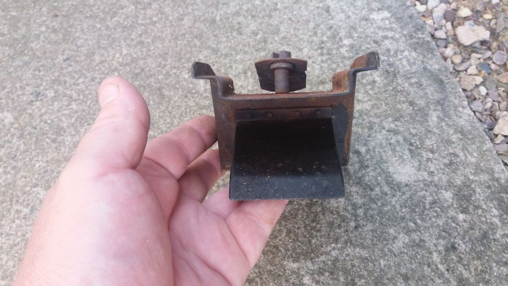

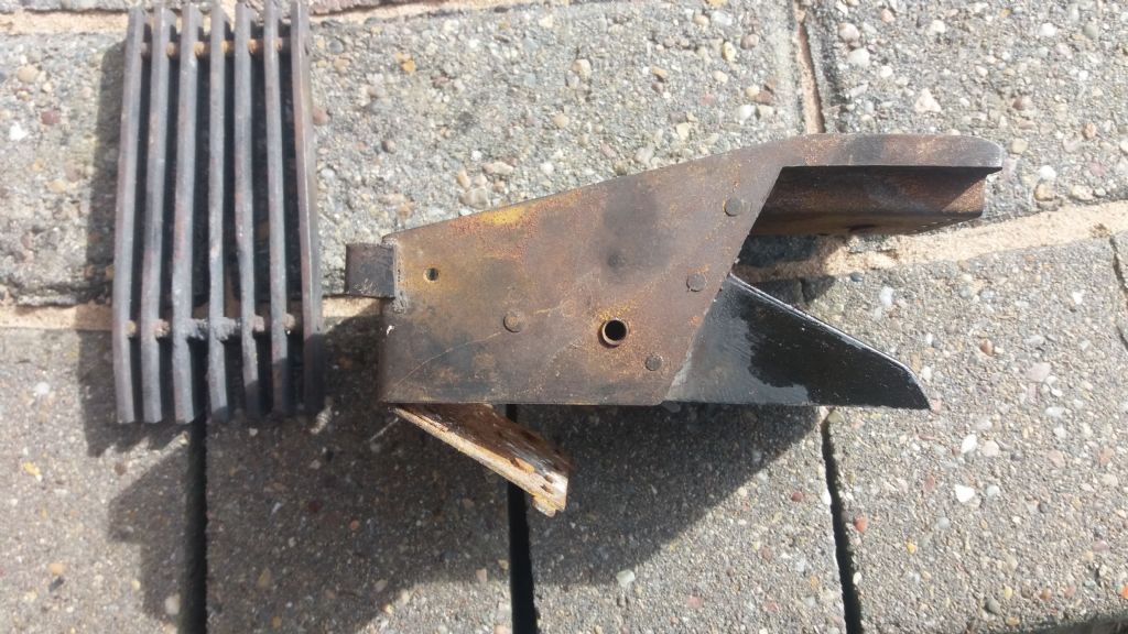

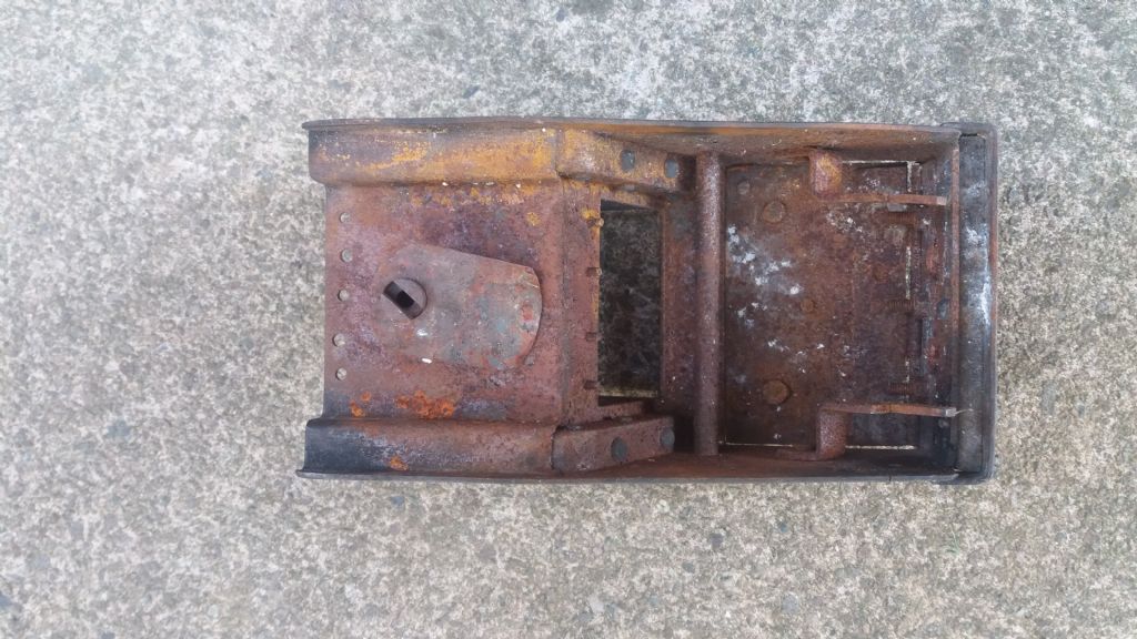

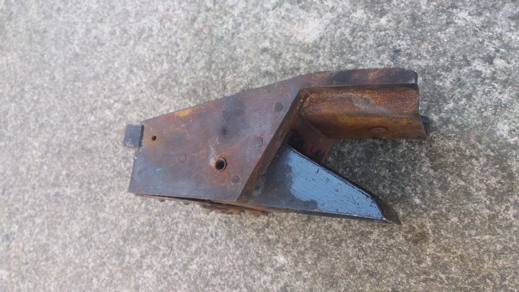

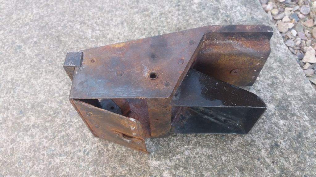

nigel Hyde 125/09/2016 20:37:52
7 forum posts
5 photos
Hi David
well here they are, I always find a nice deep fire, this design gives plenty of air and more importantly save the back axle from getting covered in ash and getting ash in the axle boxes and save a re build!
the back axle runs in the space of the scoop area, I hope that makes sense
Hope this helps

David Wasson26/09/2016 04:29:35
avatar
149 forum posts
43 photos
Hi Nigel,
Thank you for taking the time to shoot these photos. Looks like this version has the hatch to dump the ashes without removing the entire pan or grate. It also looks like it is held in by a pin that goes through the tube mounted left to right.
It's hard to tell, but, it looks like the "scoop" that goes under the axle is open where it is attached to the pan to allow for more air flow. Is this correct?
David
nigel Hyde 126/09/2016 19:07:26
7 forum posts
5 photos
Hi David
I have spoken to my dad and this is what he has said
" The ashpan is inserted up at an angle and slid between the top of the horns and bottom of firebox. A cross pin fixes it in place. Air feed is from two directions, the first horizontally, from the rear, and, as you noticed, vertically up into the scoop and into the bottom of the ashpan, through the firebars. The ashpan flap is to dump the ash when necessary and, could be left open to admit even more air if required.
The grate is held onto the ashpan by two fingers at the front and a slotted rod at the rear. In early trials I found the firebars were burning through at one point too quickly. To overcome this I placed a "button" underneath the firebars at that point to divert air around it. It worked.You can see the "button" sitting on the slotted rear grate fixing rod.Hope this is all clear "
Thanks Nigel

julian atkins27/09/2016 00:35:47
avatar
1285 forum posts
353 photos
Hi Nigel,
I thoroughly approve of the grate design, but I think the rearward shoot type extension to the ashpan completely superfluous. Just leave off part of the hinged flap to the front section on the base, and curve the top rearward section downwards with a larger gap for air space rearward and space for ash in the shallow rearward section to work down and out.
Your Dad's ashpan is overly complicated and flawed in design for air flow in the correct places, and doesnt get rid of ash under the last 2/5ths of the pan which will accumulate and eventually restrict the proper burning of the rear of the fire plus overheat the firebars.

David Wasson27/09/2016 02:35:06
avatar
149 forum posts
43 photos
Hi Julian,
It seemed to me that the rearward shoot was to keep ashes from falling onto the rear axle through the back open section of the pan and still allow for air flow. The downside to this would be that burning ashes might fall directly onto the track, at least in this portion of the pan. Any suggestions?
The ashpan for the Super Simplex is a bit different. No hinged flap. What do think of that design?
