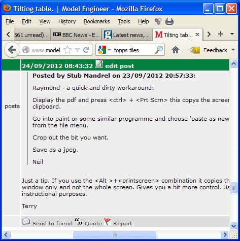

Posted by Stub Mandrel on 23/09/2012 20:57:33:
Raymond - a quick and dirty workaround:
Display the pdf and press + this copys the screen onto the clipboard.
Go into paint or some similar programme and choose 'paste as new image' from the file menu.
Crop out the bit you want.
Save as a jpeg.
Hi,
Just a simple tip. If you use the + combination it copies the open window only and not the whole screen. Gives you a bit more control and better resolution. Useful for instructional purposes.
E.G.
Regards
Terry
Edited By Terryd on 24/09/2012 08:49:42
