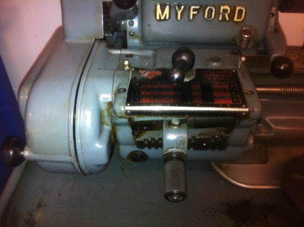

Here is a picture of my gearbox, not sure what type it is.

Your gearbox is the standard Myford Quick Change box or a Norton box in engineering parley
Regards John
