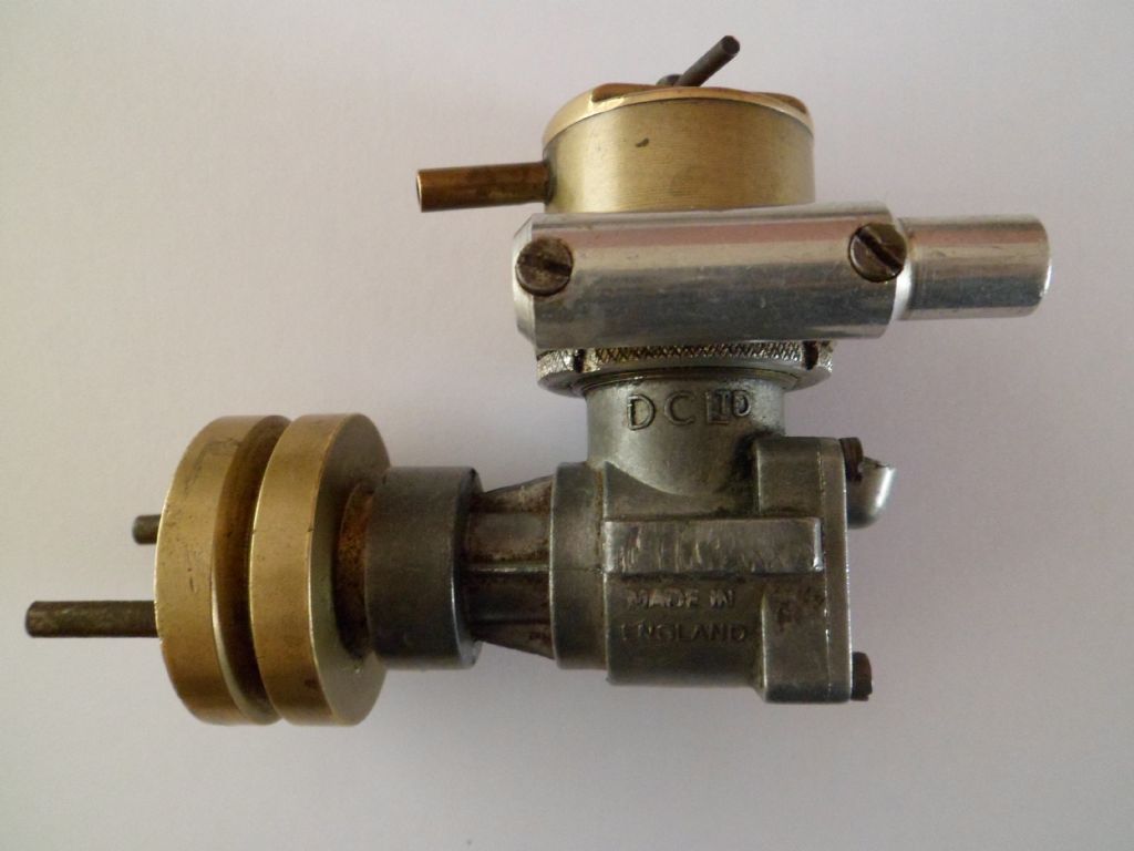

hi i have a very rare DC Rapier marine engine. it is a small model diesel engine. I need help with finding some parts/spares and help would be appreciated. regards, rich

Thankyou for getting back to me. this is the engine itself....it is marine(water-cooled)

yes-the DC engines are quite nice. Do you know anywhere i could get a liner for a rapier or maybe even get the dimensions to get one made. also if possible, i need a carb as it is missing from my engine.

works for me laugh so does anyone have any information of where i can get a liner, or atleast someone who has a Rapier already who i can ask for dimensions to make one myself?

Rich, This engine was introduced in 1956, with a green head on the aircooled version. It was re-introduced in 1973 with a blue head, but very similar. All my records show the engine to have a one piece integral intake tube, with the usual DC type needle valve, although the later one had a brass sleeve over the operating end of the needle. It would appear that you engine has had the top of the intake cut off, maybe to fit a throttle. However it will now be difficult to add the missing portion, as there is not enough length to fit an external sleeve, or to bore out and insert an extension. The originals also had a small drilled boss across the upper part of the venturi, for whar purpose I am not aware, But this is of no consequence if you only want to run the engine. Tomol.

I have an aircooled DC Rapier which I rebuilt some time back using parts from a water cooled version I do have some spares but what, I'm not sure without looking, however I can certainly measure a liner for you. What is actually wrong? If it's lack of compression you may be able to reclaim it by 'growing' the piston and relapping it and the bore. I have reclaimed several engines in this fashion. I can explain more if you wish.
I'm pretty certain I don't have a complete backplate however providing you only want it to work as opposed to returning it to it's original state you may be able to fit a turned venturi.

Rich - I have found the spares - I have a piston and liner/set up so let me know what information you need..
The pic makes it look far worse than it is - it came out of a very poor looking but well running engine. As I thought I do not have a backplate but looking at the rebuilt one if you are more concerned with getting it to run as opposed to originality then I think you should be able to remove the stub of venturi casting flush with the back plate and then tap the hole to take a venturi insert which could easily be turned from bar.
My only doubt, without stripping the backplate off, is whether there is enough depth of material for a thread to take. I can't remember exactly how the intake timing is set up on the inner face - it's important any work you do does not affect that.
