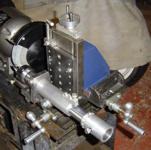

Les Jones 111/12/2011 09:17:15
2292 forum posts
159 photos
Hi Neil,
Thanks for the comment but I do not think it is in the same league as a "Quorn" It just seemed a cheap and lazy way to make a support to use Harold Halls end mill and four facet drill sharpening jigs. Before anyone comments on the wheel coming off when the motor is running in reverse (As it needs to be sharpening the end mill.) the hub is keyed onto the shaft.
By the way Neil, how did you insert the picture before the post ?
Les
Edited By Les Jones 1 on 11/12/2011 09:18:52
Harold Hall 111/12/2011 18:21:22
418 forum posts
4 photos
I like the idea Les, makes me wonder why I designed my grinding rests.
What is the studding for, bottom right, is it an adjustable stop.
I think perhaps that David would like it as an article for MEW.
Glad you find the end mill sharpening and four facit drill sharpening jigs useful!
Harold
Les Jones 111/12/2011 18:55:28
2292 forum posts
159 photos
Hi Harold,
You are correct. The studding is an adjustable stop which I fitted for use with the four facet drill grinding jig. I am not happy with the stop as it has to stick out so much and is in the way when turning the feed handle. I am also thinking of replacing the original feed screw with one with a finer thread. Other problems with the design are that the angle to which the table can be set is limited by the back end of the plate touching the space between the jaws. another problem is although the pivot for the plate is as close to the wheel as I can get the grinder has to be raised or lowered at times by adding or removing spacers. The table only pivots on one axis whereas yours pivots on two axis. I find your two jigs very useful. The only problem I find with the drill grinding jig is that larger drills tend to rock in the V grove. I think increasing the length of the V groove will solve this problem. You may just be able to see that I moved the grub screws to the corner of the square bar to give a longer length of thread when there is a large hole through the bar for big cutters. The grinder head is also your design with the addition of a reversing switch and the hub being keyed to the shaft. By the way I am very impressed with your website.

Les Jones 129/12/2011 09:00:44
2292 forum posts
159 photos
I noticed that Axminster Tools have cross vices on the sale page of their website. The 3" one is £17.44 I think this would be a cheap basis for a low cost tool grinder.
Les.

Les Jones 117/02/2013 18:14:55
2292 forum posts
159 photos
Hi IanT,
Here is a closer view of my lash up tool grinder.
There are more pictures in "My Photos"
John has just proved a point that was made on another thread that that if you have an idea then someone has had the same idea before. Sorry John I only used black angle and plate. Only the top surface of the table was machined.
Les.

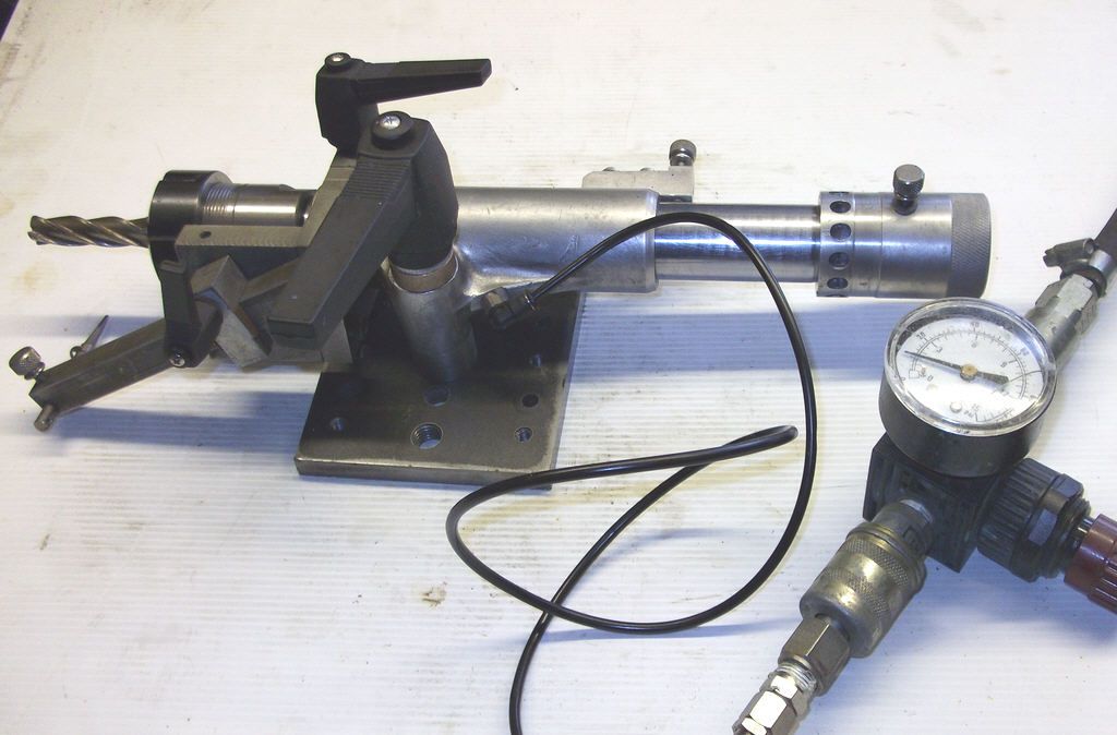

Bill Todd21/03/2013 14:39:02
2 forum posts
4 photos
Knocked up something similer a while ago. I used a motorcycle forkleg as a slide for grinding endmill flutes
Edited By Bill Todd on 21/03/2013 14:45:17
